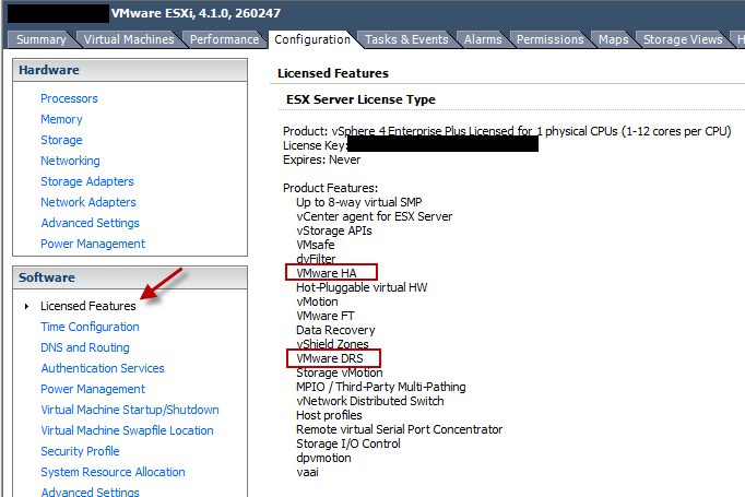

    To view your licensed features:
    1. Open the vSphere Client and connect to your vCenter server
    2. Select a host in your cluster
    3. Click on the Configuration tab
    4. Click on the "Licensed Features" link under Software
    All of the licensed features are presented here. Look for "VMware HA" and "VMware DRS" to see if they are licensed.

    Thanks Chris
    No mention of HA or DRS there on my essentials
    I guess the fact that they are not greyed out is just a glich then
