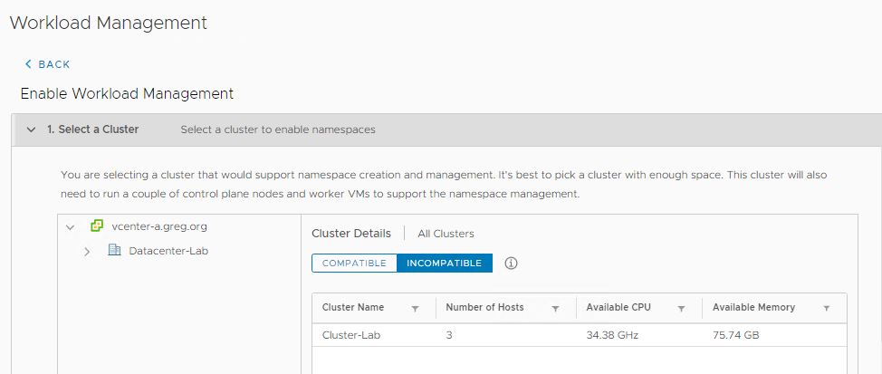

    trying to enable workload management in vsphere 7 but cluster is not compatible.
    i validate the following are set: 3 ESXi hosts, DRS on , HA on, NSX-T 3.0 is running with trust enabled , hosts license with VMware vSphere 7 Enterprise Plus with Add-on for Kubernetes
    also i'm getting this error when running cluster compatibility from within the vcenter.
    |cluster     |compatible|incompatibility_reasons                              |
    |domain-c2026|False     |Cluster domain-c2026 is missing compatible NSX-T VDS.
    any advice what else can be the cause?
    thanks

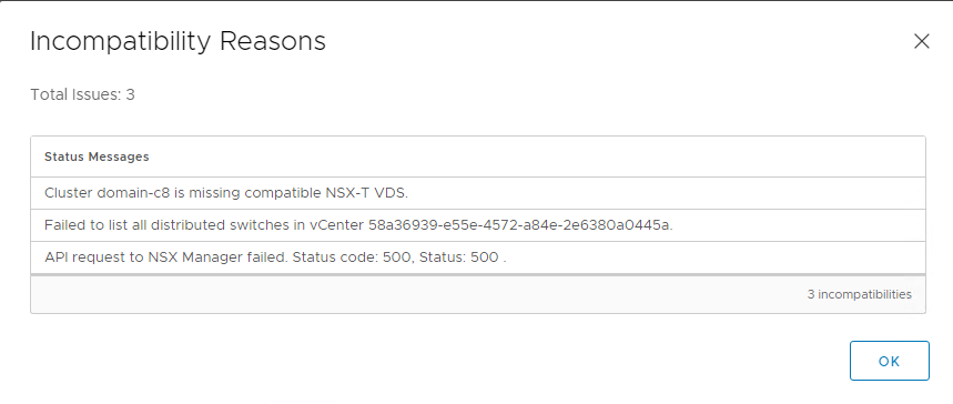

    Posted Oct 26, 2022 10:09 PM
    Hi,
    This is an error I received during the cluster validation
  • 10.  RE: Cluster is not compatible for Workload Management
    Posted Oct 26, 2022 11:16 PM
    What I found was the VCenter server is unable to communicate with the NSX-Manager. This was due to an issue with the Domain Controller. The trust between NSX-Manager and the vCenter wasn't established due to the domain name resolving issue. Finally managed to fix.

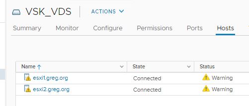

  • 12.  RE: Cluster is not compatible for Workload Management
    Posted Jun 24, 2020 01:07 PM
    Do you have ESXi hosts joined to this vDS that are below version 7.0 GA?
  • 13.  RE: Cluster is not compatible for Workload Management
    Posted Jun 24, 2020 01:26 PM
    daphnissov​,
    yes already joined..
  • 14.  RE: Cluster is not compatible for Workload Management
    Posted Jun 24, 2020 01:45 PM
    Not what I asked. I asked what version were the hosts you have joined to the vDS.
  • 15.  RE: Cluster is not compatible for Workload Management
    Posted Jun 24, 2020 01:54 PM
    upss, Im sorry, not all the words I read.
    the esxi version is 7 GA..
  • 16.  RE: Cluster is not compatible for Workload Management
    Posted Jun 24, 2020 02:05 PM
    It doesn't like host-16 for some reason. Are they both licensed for the vSphere 7 with Kubernetes add-on? If not, that's likely the issue.

  • 18.  RE: Cluster is not compatible for Workload Management
    Posted Jun 25, 2020 02:18 AM
    Are you able to spot at differences between how that one host attaches to the vDS versus the other?
  • 19.  RE: Cluster is not compatible for Workload Management
    Posted Jun 25, 2020 03:22 AM
    Still got incompatible after I add one host and not attached to VDS
