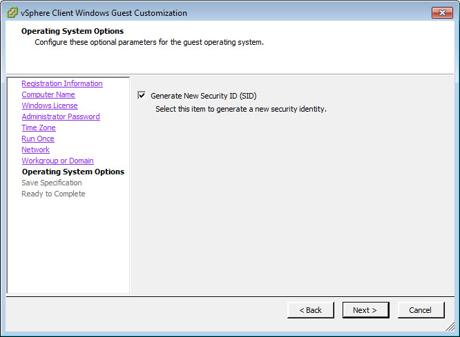

    Hi all
    Please assist On Vcenter I`ve cloned a vitrual machine as it is, form one datastore to another but are on the same host, the challenge I want to use both machine for different purpose  but I can`t power on  both machne, it seems that there is a conflicts error about trust relationship when I power the other machine trying to change IP Address , what can I do to break the relationship between the VM`s.

    Posted Oct 06, 2015 06:38 PM
    When you clone it, and you go through the wizard, use Customize using the Customization Wizard, and on the last screen you need to check-mark the Generate New SID option.  This will run it through sysprep and you won't have that issue.

    Posted Oct 06, 2015 10:47 PM
    When you clone it, and you go through the Customization wizard , use Customize using the Customization Wizard, and on the last screen you need to check-mark the Generate New SID option.  This will run it through sysprep and you won't have that issue.

    Hi All
    Thankx a lot Guyz you saved me; I`m sorted now.......:smileyhappy::smileyhappy::smileyhappy:. by the time I was cloning I didn`t change the SID
