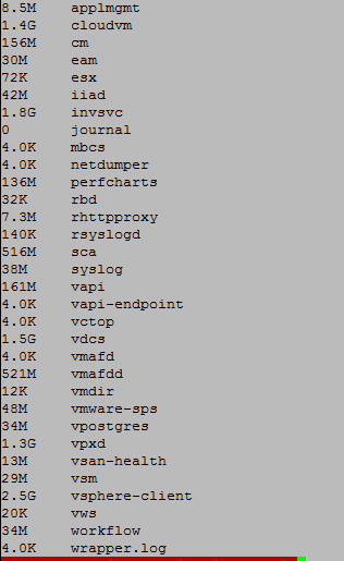

  • 4.  RE: cleaning out old logs in vcsa 6
    Posted Dec 28, 2017 04:21 PM
  • 5.  RE: cleaning out old logs in vcsa 6
    Posted Dec 28, 2017 04:25 PM
    another one
  • 6.  RE: cleaning out old logs in vcsa 6
    Posted Dec 28, 2017 04:28 PM

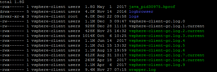

    In your case, you probably have some large Java heap dumps (from crashes in the web client) at vsphere-client, which is fairly common. ls -lh inside that directory to show its contents.
  • 7.  RE: cleaning out old logs in vcsa 6
    Posted Dec 28, 2017 04:30 PM
  • 8.  RE: cleaning out old logs in vcsa 6
    Posted Dec 28, 2017 04:31 PM
    You can remove the java_pid30975.hprof files which is 1.8GB size from that folder. It looks like the vCenter is with external PSC.
    thanks,
    MS
  • 9.  RE: cleaning out old logs in vcsa 6
    Posted Dec 28, 2017 04:32 PM
    That .hprof file is a Java dump and can be removed. I see you also have a logbrowser directory which indicates you've done some generation from within the web client. Do a du -sh * inside the current directory and show its size. Usually things inside logbrowser can be removed.

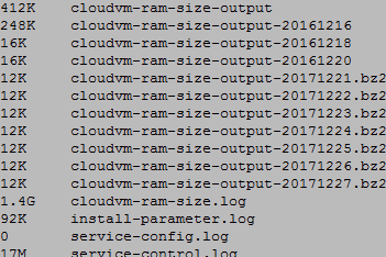

    Also, the cloudvm folder size is huge so I guess you might be hitting issue similar to the one discussed on this VMware Knowledge Base
    Rather than doing workaround in that KB. You can just make that file 0 size by below command. This will just make the file size zero bytes if its large
    cat /dev/null > /storage/log/vmware/cloudvm/cloudvm-ram-size.log
    Thanks,
    MS

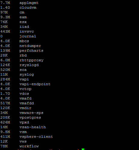

  • 11.  RE: cleaning out old logs in vcsa 6
    Posted Dec 28, 2017 06:59 PM
  • 12.  RE: cleaning out old logs in vcsa 6
    Posted Dec 28, 2017 07:01 PM
  • 13.  RE: cleaning out old logs in vcsa 6
    Posted Dec 28, 2017 07:16 PM
    1.4GB is taking by cloudvm-ram-size.log. You dont need to delete. If you do not want this log then you can make it to 0 by using the above command. It is generic unix command.
    Thanks,
    MS
