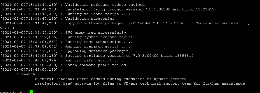

  • 13.  RE: Can't patch beyond VCSA 7.0.1.00300: Invalid Type,expected String, instead got NoneType
    Posted Sep 08, 2021 03:11 PM
    I ran into the same issue trying to upgrade from 7.0.1.0020 to 7.0.2.00400.  We were doing the upgrade from the appliance shell with the ISO mounted from a datastore to the vcenter vm.  The error message was less than helpful
    In our case, this vcenter had been upgraded from 6.7 to 7.0 and were originally part of an external PSC and then converted to embedded  as part of the upgrade.  Clues to the issue were found near the end of  /storage/log/vmware/support/applmgt/PatchRunner.log file on the vcenter appliance.
    vmdir: Patch ERROR faled to delete the legacy schema tombstone entry on DC testdc.mydomain.com.
    vmdir .Patch ERROR ldap_delete: No such object (32)
    additional info : (9703) ( MDB_NOTFOUND: No Matching key/data pair found
    There were remnants of and old sso domain (testdc.mydomain.com) members remaining in the PSC and we were able to identify and delete from sections
    'Domain Controllers', DomainDNSZones'  using  jxplorer tool before attempting the upgrade to 7.0.2.00400.
    After reverting the vcenter snapshot, using jxplorer to clean up the orphaned entries, the next upgrade attempt was successful.
    Hopefully, this is helpful .

    [2021-10-09 23:05:46,435] : Upgrading software packages ....
    [2021-10-09T23:07:57.282] : Setting appliance version to 7.0.3.00000 build 18700403
    [2021-10-09 23:07:57,663] : Running patch script.....
    [2021-10-09T23:09:53.282] : Patch command patch failed
    Mismatch:
    summary: Internal error occurs during execution of update process Traceback (most recent call last):
    File "/storage/core/software-packages/scripts/patches/py/vmware_b2b/patching/phases/patcher.py", line 203, in patch
    _patchComponents(ctx, userData, statusAggregator.reportingQueue)
    File "/storage/core/software-packages/scripts/patches/py/vmware_b2b/patching/phases/patcher.py", line 84, in _patchCompo
    _startDependentServices(c)
    File "/storage/core/software-packages/scripts/patches/py/vmware_b2b/patching/phases/patcher.py", line 53, in _startDepen
    serviceManager.start(depService)
    File "/storage/core/software-packages/scripts/patches/libs/sdk/service_manager.py", line 901, in wrapper
    return getattr(controller, attr)(*args, **kwargs)
    File "/storage/core/software-packages/scripts/patches/libs/sdk/service_manager.py", line 794, in start
    super(VMwareServiceController, self).start(serviceName)
    File "/storage/core/software-packages/scripts/patches/libs/sdk/service_manager.py", line 665, in start
    raise IllegalServiceOperation(errorText)
    service_manager.IllegalServiceOperation: Service cannot be started. Error:
    resolution: Send upgrade log files to VMware technical support team for further assistance.
