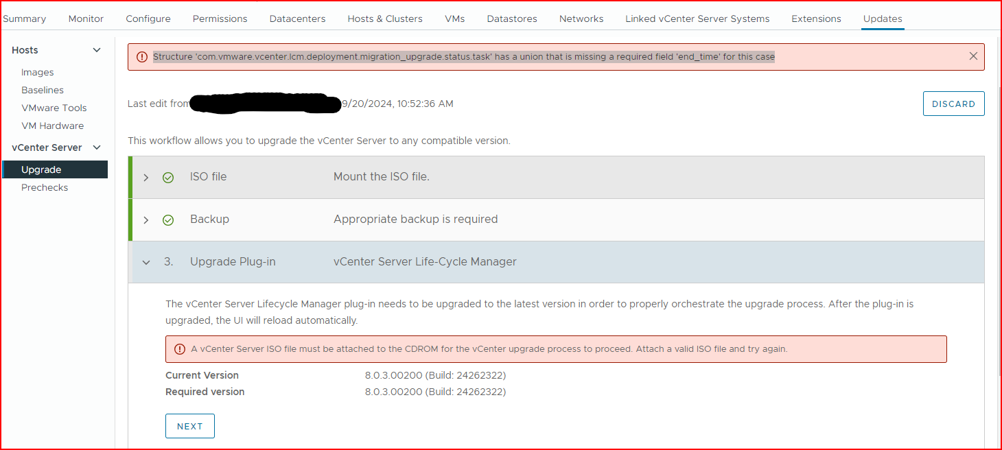

    Several time tried to upgrade vCenter using RDU but anytime didn't succeed.
    Just upgraded a plugin and can neither configure target appliance (error with no text) nor discard upgrade workflow.
    Got an error:
    Structure 'com.vmware.vcenter.lcm.deployment.migration_upgrade.status.task' has a union that is missing a required field 'end_time' for this case

    Could you please share the environment details such as the source & target vCenter version, also do you have ELM or VCHA configured? Do you have a snip and where do you see this error ?

    I'm also having this issue at one of our sites with the same error. I upgraded the patches in the manager portal, but in vcenter it thinks it's sill processing the update. Reboots have not resolved the issue. I have found if i mount or unmount the ISO, the vm crashes and the changes do not actually take affect.
    Has anyone found a solution?
