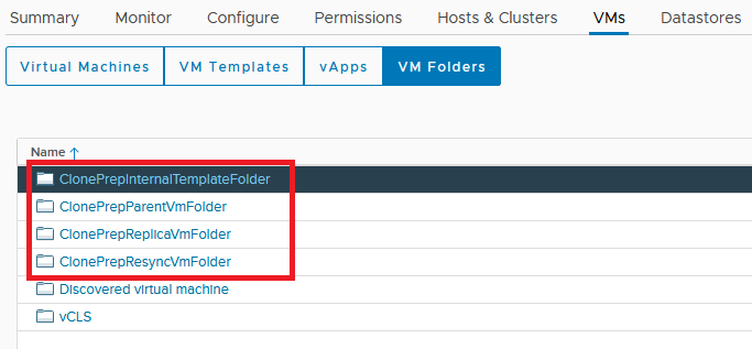

    I was testing the Horizon application and my company has decided to not move forward with it.  I have removed all the test vms and servers I needed to created the environment with.  I noticed today that I still have the ClonePrep folders listed in the inventory.  They do not have anything inside them and when I go to delete them...nothing happens.
    Can anyone assist me with what I might need to do to delete these empty folders?

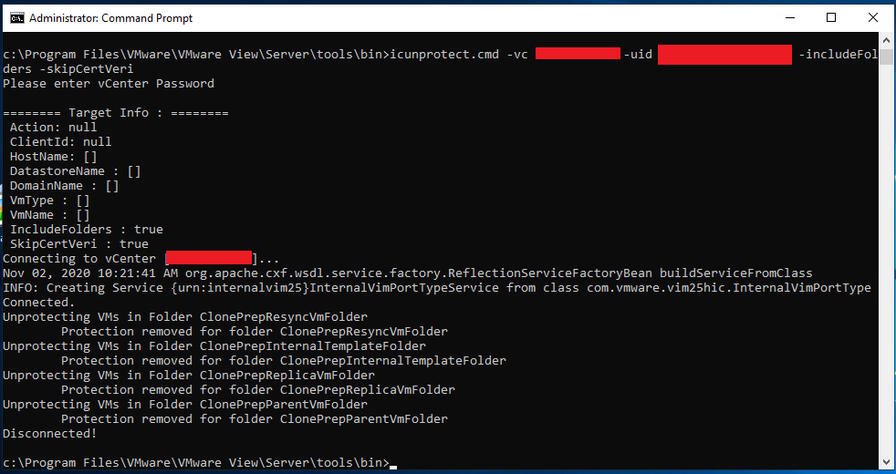

    ***UPDATE:
    I created a new VM, installed Horizon on it.  I did not have to go into the portal and reconfigure all the connections.  I ran the icunprotect.cmd with the -includeFolders paramter.  After it logged in...it spit out some text saying the folders were unprotected and then disconnected itself.  I then went into the vCenter and was able to delete the folders.
