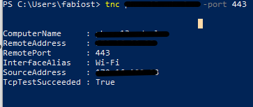

    Ciao
    Do you have checked the connection to the 443 TCP port?
    Open PowerShell and use this command:
    tnc <ESXi Hostname> -port 443
    if the 443 port is open on the output is
    If TcpTestSucceeded is False the port 443 (https) is close It could be a firewall problem (Windows Firewall, Network Firewall or ESXi Firewall)

  • 4.  RE: Can't connect to esxi 6.7 web UI
    Posted Feb 08, 2022 08:01 PM
    Thanks for the responses.
    The nc test succeeded on the server and the tnc test was successful from my windows server on the same vlan. From my workstation on a different vlan, the tnc test had a successful ping but TcpTestSucceeded was false.
