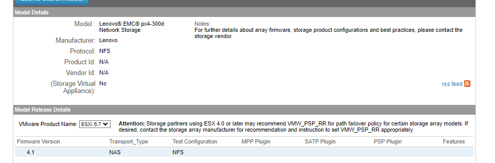

    Also, it should not be related but v6.7 is out of support, even out of technical guidance too. You should get this upgraded asap.
    Kindly note that as per this Hardware Compatibility Guide Link, it supports only NFS v4.1.

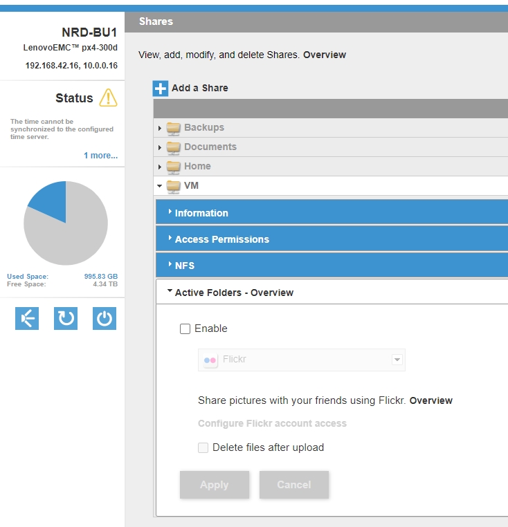

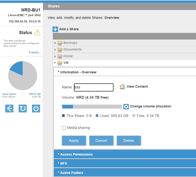

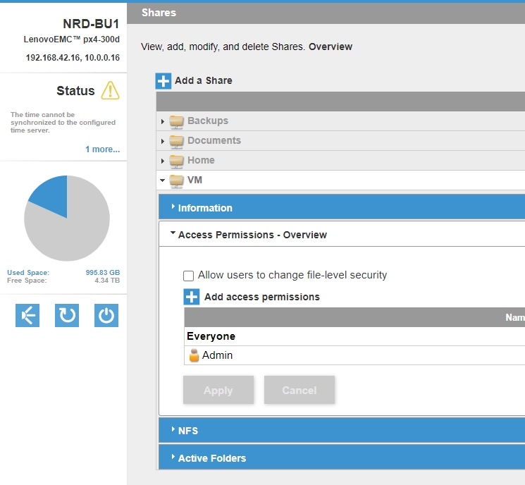

    I do not have a Linux machine to be able to test anything. Attached are the screen shots of the NSF setup.

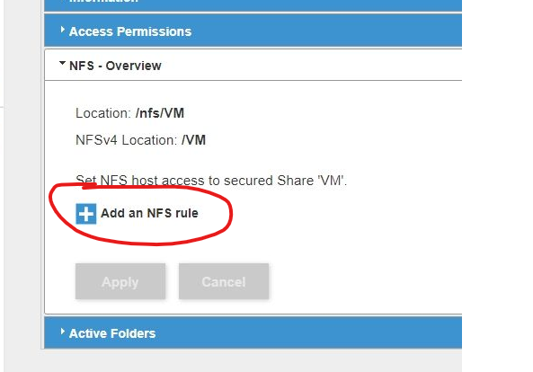

    Add your Esxi host ip address here:
    And please show us how you mount it from the Esxi host.

    Posted Dec 18, 2023 05:20 PM
    Just put the IP address in that box? Nothing else?

    Yes, just the IP. This says that the host has permission to access the NFS share. You may also try using the IP rather than the name when trying to connect from the ESXi host. The documentation says "For the server name, you can enter an IP address, a DNS name, or an NFS UUID". I have found at times the IP works better. Address any potential DNS issues. Also, have you tried pulling the logs from the path in my previous post and uploading them? That may give us a better idea of the issue.

    In the VMWare compatibility guide it says this...
    "Attention: Storage partners using ESX 4.0 or later may recommend VMW_PSP_RR for path failover policy for certain storage array models. If desired, contact the storage array manufacturer for recommendation and instruction to set VMW_PSP_RR appropriately."
    https://www.vmware.com/resources/compatibility/detail.php?deviceCategory=san&productid=36586&releases_filter=369&deviceCategory=san&details=1&partner=51&releases=369&isSVA=0&page=8&display_interval=10&sortColumn=Partner&sortOrder=Asc

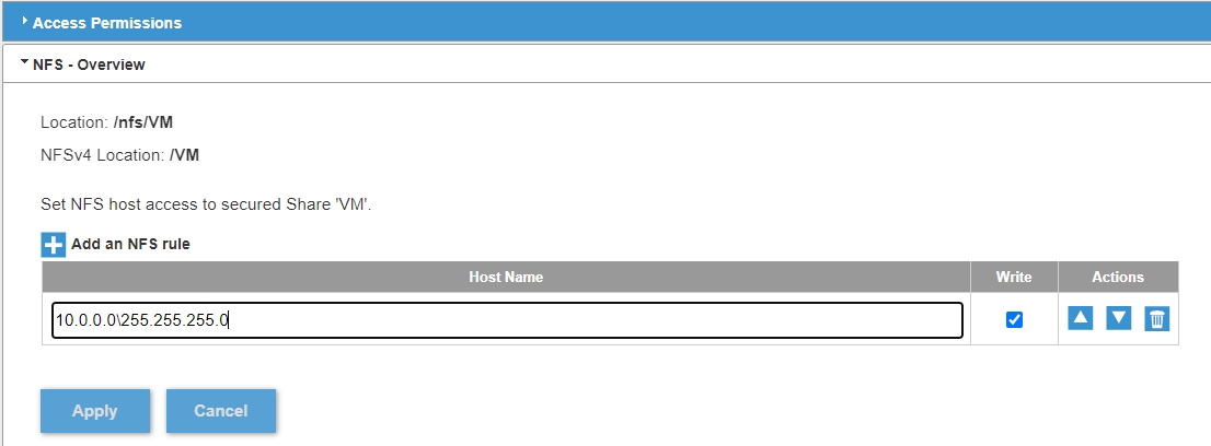

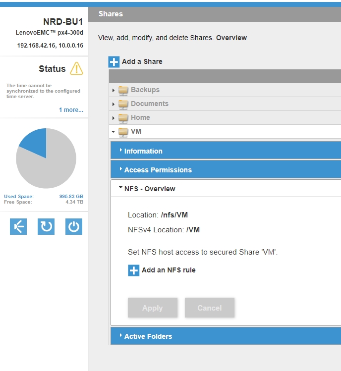

    Don't give up - I'm sure we can find the issue
    Can you post a screenshot of the NFS Rules you have made? Also, what creating a new one looks like?

    Posted Dec 20, 2023 08:47 PM
  • 31.  RE: Can't add NSF datastore
    Posted Dec 20, 2023 08:52 PM
    Lets try two dumb things:
    1. Create a host entry with *
    2. Change your current one from "\" to "/"
  • 32.  RE: Can't add NSF datastore
    Posted Dec 20, 2023 08:57 PM
    THAT WORKED!!!!! OMG Now I am crying, I'm so happy!

    Which one worked? The wildcard or the forward slash "/"?
  • 34.  RE: Can't add NSF datastore
    Posted Dec 20, 2023 09:16 PM
    The forward slash. Of course had I noticed it when I first entered it, but I'm glad you did. Now to get the files moved. The synology keeps dropping the connection so it's going to be a process but I'm hopeful.
