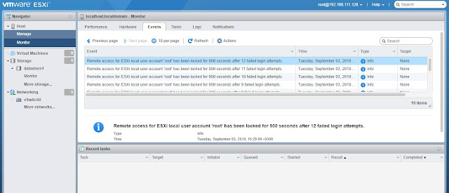

    Posted Mar 29, 2022 01:30 PM
    Solution:
    1) Login to ESXi Direct Console Interface (DCUI) with "root" account.
    2) Press "F2", go to "Troubleshooting Options".
    3) Enable "ESXi Shell" using "Enable ESXi Shell" Option and go back to main menu.
    4) Press "CTRL+ALT+F1" to switch to "ESXi Shell"
    5) Type Command "pam_tally2 --user root" to view total failed login attempt from root.
    from below example, There are 14 failed login attempt.
    6) Type Command "pam_tally2 --user root --reset" to reset the lock.
    7) Now we will be able to login to ESXi via vSPhere Client or web client.
    ESXi events showing the failed login attempts and "root" locked events.
    Prevent The Account Lock Again
    1. Login to ESXi via SSH (Enable SSH from ESXi settings if SSH not enabled)
    2)  type Command "tail -100 /var/log/auth.log" to view last 100 events on auth.log
    3) The result showing the source IP from where the failed login attempt is originated, In below example, the IP is "192.168.111.1"
    2019-09-03T13:09:57Z sshd[2101425]: pam_unix(sshd:auth): authentication failure; logname= uid=0 euid=0 tty=ssh ruser= rhost=192.168.111.1  user=root
    2019-09-03T13:09:59Z sshd[2101419]: error: PAM: Authentication failure for root from 192.168.111.1
    2019-09-03T13:09:59Z sshd[2101419]: Failed keyboard-interactive/pam for root from 192.168.111.1 port 64744 ssh2
    2019-09-03T13:09:59Z sshd[2101426]: pam_tally2(sshd:auth): user root (0) tally 6, deny 5
    4. Identify the source machine and resolve the reason of multiple login attempt.
    Example:
    If the source IP is for backup software, reconfigure backup with latest ESXi Credentials.
