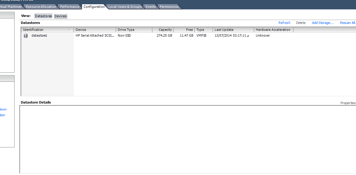

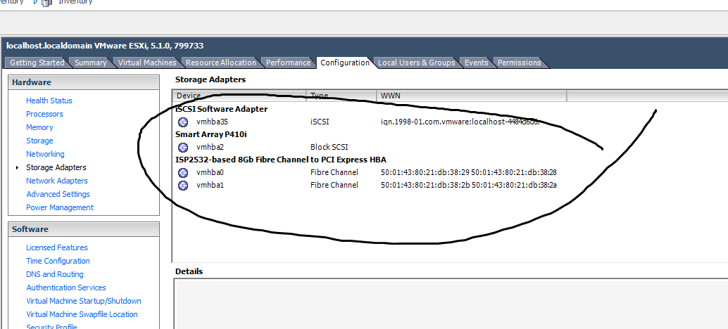

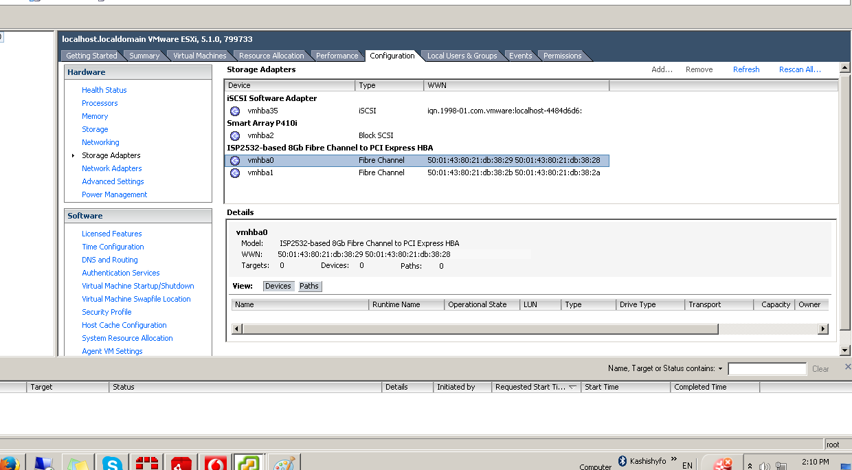

    Hello everyone,
    I used to add datastores before and this is the first time I encounter this problem. The only difference today that I have just installed Vcenter server and began to use it to manage my hosts (I am not sure if this has anything to do with my problem).

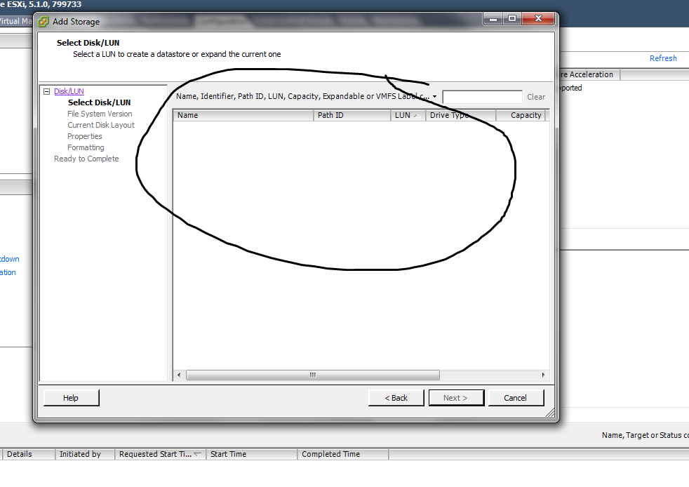

    I am able to see all storage adaptors of this host but when I try to add new storage : at the "select a LUN to create a datastore or expand the current one" window:
    I cannot see any of the LUNs to select one !!!!!
    Even the storage devices attached to those LUNs are up and working, but when I try to add new storage I donnot see any of them.
    Thank you for you help please see the photos

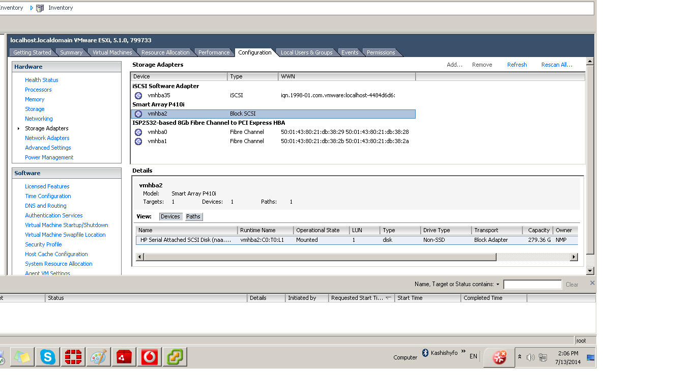

    Can you confirm that the new LUNs are presented to the host, i.e. do they show up when you select the appropriate Storage Adapter? Maybe a Rescan is required.
    André
  • 3.  RE: Cannot add a new storage to my esxi host (LUN disappeared)
    Posted Jul 13, 2014 01:38 PM
    I have done rescaning manytimes.
    The thing that confusing me that when I browse "storage adaptors" I found everything is ok, but within the "add new storage" wizard, nothing to select from! (as attached photos)
  • 4.  RE: Cannot add a new storage to my esxi host (LUN disappeared)
    Posted Jul 13, 2014 01:40 PM
    In the screen shots you posted, there's no LUN showing up. Can you confirm that you see the LUNs in the lower pane when you select the storage adapter(s).
    André
  • 5.  RE: Cannot add a new storage to my esxi host (LUN disappeared)
    Posted Jul 14, 2014 12:17 AM

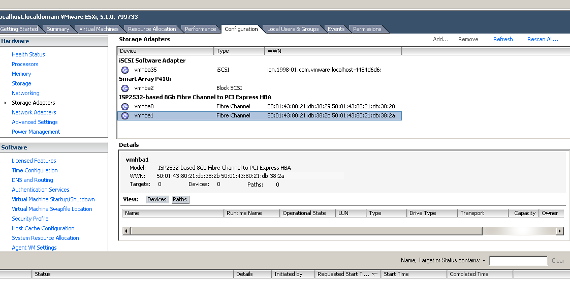

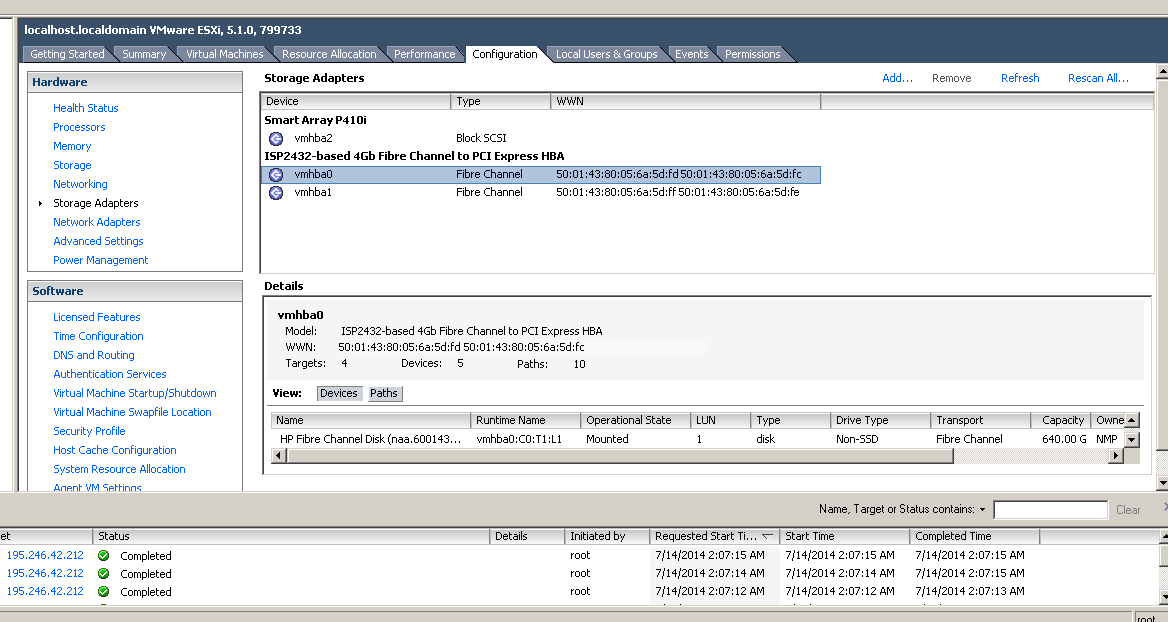

    First of all guys thank you for being so helpful.
    And Andre, I have more than one host all facing the same problem, I noticed in the first host that I can see the LUN for the SCSI adaptor but none of the fiber chaneels
    u
    however the other host I can see one of the its two fiber channels ( most propably the one that is online)
    the problem is during the add new storage wizard I see nothing at all , even those adaptors that seems up.
  • 6.  RE: Cannot add a new storage to my esxi host (LUN disappeared)
    Posted Jul 14, 2014 08:53 AM
    To me this looks like either a zoning issue with the FC fabric, or a presentation issue on the storage array. Please confirm that the hosts (HBAs) are properly zoned and the correct zone configuration is enabled. Then take a look at the storage array and ensure the LUNs are presented to the ESXi hosts.
    André
