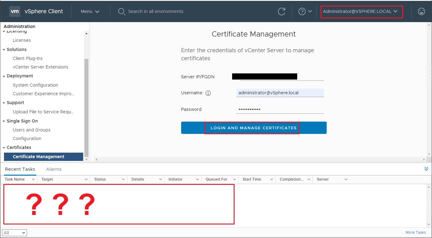

      |   view attached
    Hi,
    sorry for the late reply. I was on vacation.
    Unfortunately, still not possible to login into Certificate Management.
    Tried to "toggled the domain for the administrator account" without success
    Still the same error:   n.json is not a function
