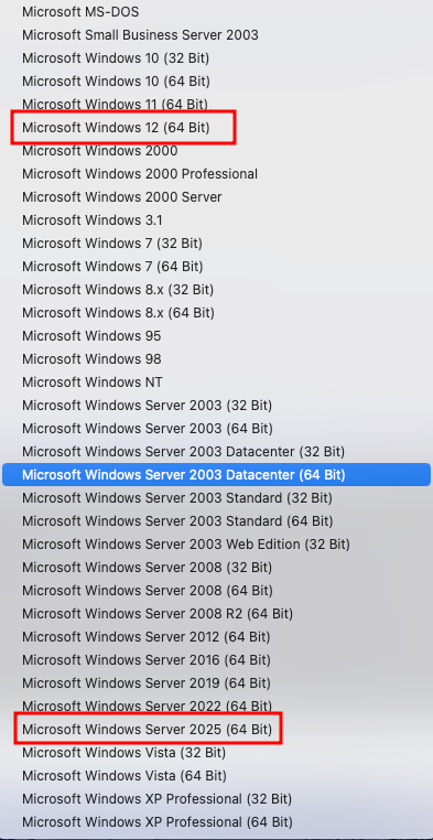

    Also I was wondering about the hw-profiles in ESXi 8 like "Windows Server 2025" and some macOS Profiles from the moon? Looks like VMware can show in the future.

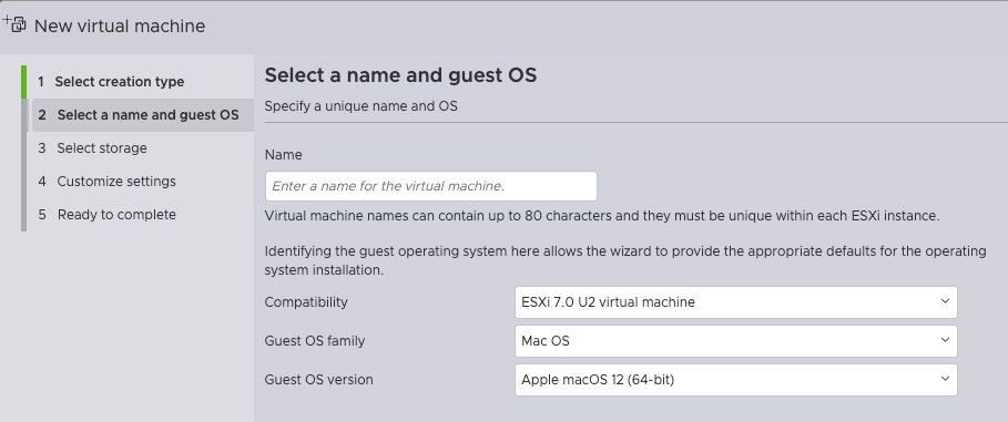

    Hi,
    You can go with Ventura on ESXi8 with the hardware profile "ESXi 7 and macOS 12" before you are creating an virtual machine. After that the setup from macOS Ventura will comes up correctly. You can checkout the picture below what you have to too choosing during the vm creation.
    The virtual machine is running smooth and fine but just not with the newst hw profile. When I upgrade the hw profile to ESXi8 and macOS 13 .. the kernel panic begins and idk why.

    I thought it might be too good to be true:
