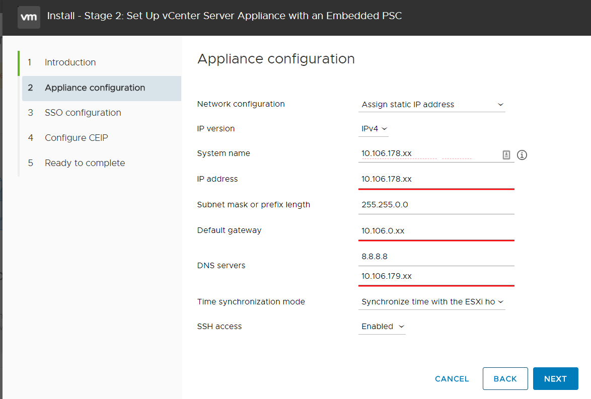

    I'm on this screen:  (I added the xx for the last octets to mask our IPs)

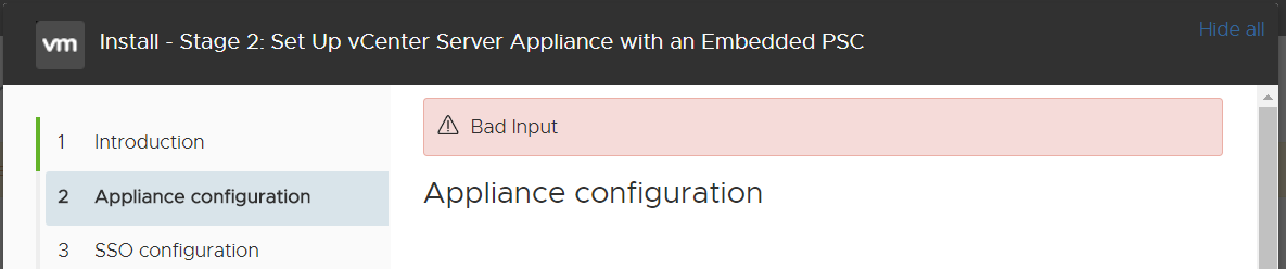

    I hit Next, it shows it is saving the information, saving host name, then I get this:

    You need to delete and re-deploy this vCSA because of these reasons:
    1. The system name MUST be a fully-qualified domain name (FQDN). Prior to you even launching this installer wizard, you MUST have both forward and reverse DNS entries established in local DNS.
    2. A DNS server cannot be a public DNS server (8.8.8.8). The appliance will attempt to look itself up from that server and will ultimately fail. Never point internal infra at public DNS.
    3. You're choosing to sync time with the underlying ESXi host. Generally that's not a good idea and you should be using internal NTP (not external NTP). Ensure your ESXi host is point at the same server and the time between that host, your workstation, and the NTP server itself are all in sync. Too much time drift and the installer will fail.
    In short, DNS and proper time keeping are extremely important in enterprise infrastructure and for vCenter as well. If one of those pieces is off you'll see failures.
