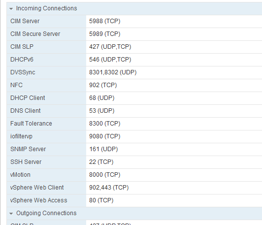

    I want to backup VM use Veeam. But ti's failed.
    show "NFC storage connection is unavailable." error.
    I check backup log that show "Establishing connection with the host [esxi]. Port: [902]. Failed."
    Then I  check ESXi host Firewall, the 902 port is open in Incoming Connections.
    What should I do?
    My vCenter Server is 6.5
    ESXi host is 6.5
  • 2.  RE: Backup VM filed use Veeam
    Best Answer
    Posted Nov 06, 2019 06:25 PM
    Is the Veeam Backup (or Proxy) server in the same subnet as vCenter Server/ESXi?
    Are there any network firewalls active between subnets?
    Can you confirm that the Backup Server has proper network access to vCenter/ESXi, i.e. is not redirected by a Proxy server setting on the Backup Server?
    See also whether https://www.veeam.com/kb1198 helps.
    André
  • 3.  RE: Backup VM filed use Veeam
    Posted Nov 07, 2019 12:07 AM
    The Veeam Backup Server is in the same subnet as vCenter Server/ESXi.
    Veeam Backup Server to vCenter Server/ESXi network is OK. I can access them on the Veeam Backup Server.

  • 6.  RE: Backup VM filed use Veeam
    Posted Nov 08, 2019 03:15 AM
    This is a network issue. It has to do with distributed switches.
    I change to other network, then it's OK.
