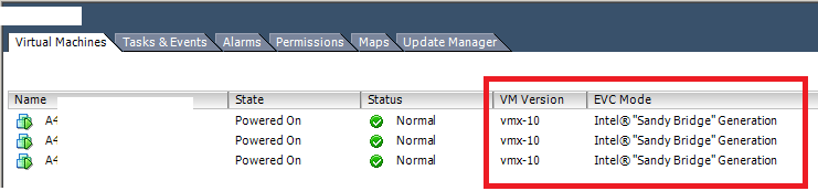

    To rule out an issue with the GuestOS, can you just boot the VM into a live Linux image and check the following command to reliably determine whether AVX is available?
    # grep -i avx /proc/cpuinfo
    AVX instructions were introduced with Sandy Bridge generation CPUs, and the CPU you mentioned should support it. It's possible they have EVC enabled on a cluster with an older CPU pre-Sandy Bridge baseline where AVX and other newer instructions are masked from the Guest to enable live migration across different CPU generations.
    Check the EVC mode on the cluster and what mode the VMs are running with at runtime. At the same time make sure the VM hardware version is at least 10 and upgrade if necessary. It should basically look like this in the GUI:
    VMware KB: Enhanced vMotion Compatibility (EVC) processor support
    You may also need to reset any custom CPU masks:
    Change CPU Identification Mask Settings in the vSphere Client
