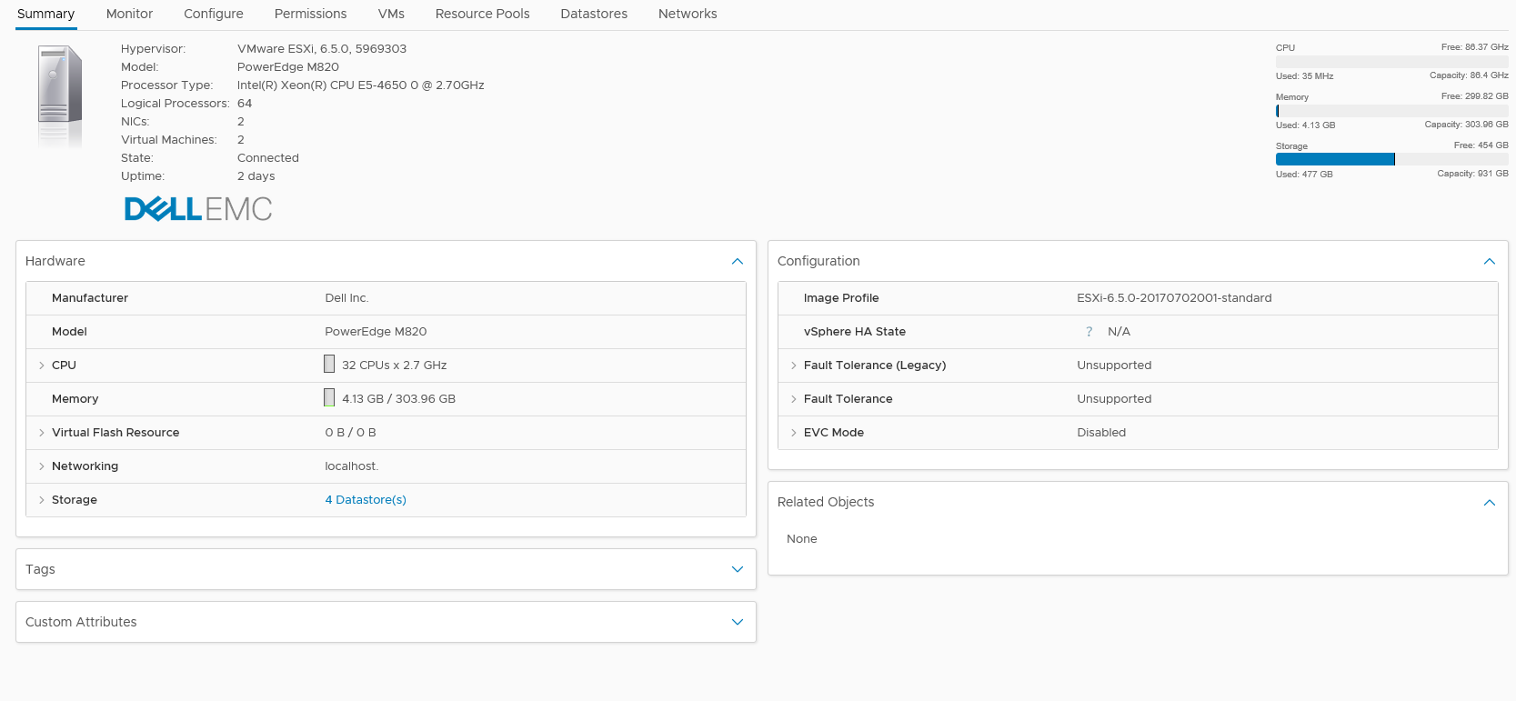

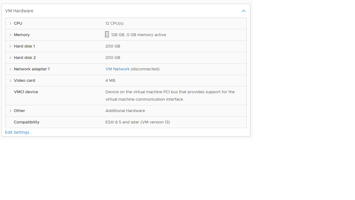

    Posted Jan 29, 2018 01:18 PM
    Hi ranchuba,
    added a screenshot of the Host Config's and VM information.
    Matt
