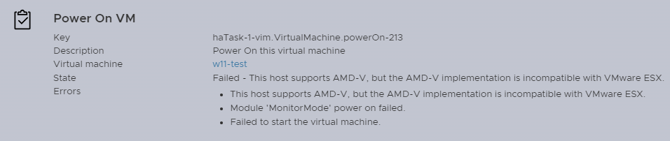

    Using nested vSphere 8.0 Update 1c (ESXi build-22088125 and vCenter) on AMD EPYC 7763 processor:
    Failed to power on virtual machine. This host supports AMD-V, but the AMD-V implementation is incompatible with VMware ESX.
    It immediately fails when starting any VM, whether it is Windows or Linux.
    Not sure if it is related to this issue that Update 1c was supposed to fix.
    This is driving me nuts: any ideas or workaround please?
    Thank you.

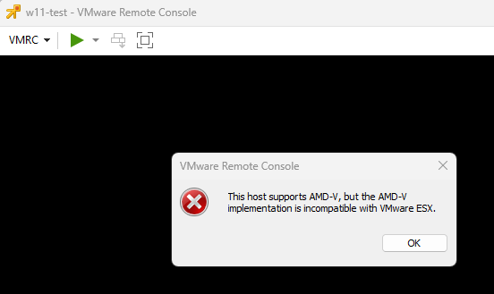

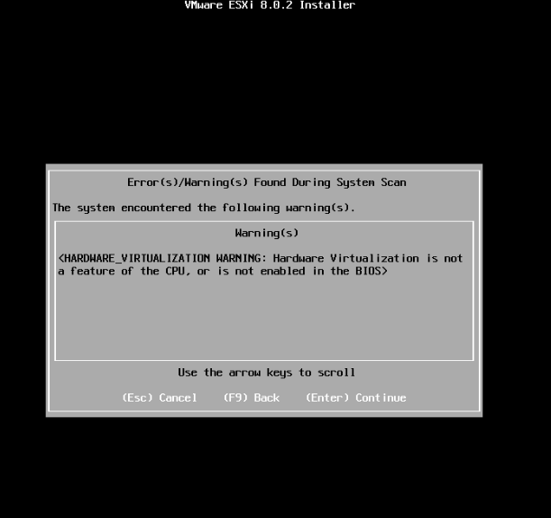

    Posted Oct 10, 2023 11:58 PM
    That's right, running nested ESXi 8.0U2 attempting to power on a Windows or Linux VM on AMD processor.
    Tried with EPYC 7763 and Ryzen 9 5950X, same issue on both processors!
    Works just fine with nested ESXi 7.x on the same hardware/config
    Please find the logs included as well as some screenshots.
    Any help would be greatly appreciated.
    Thank you.
    VM Logs (vmware.log):
    vmware.log
    ESXi Logs (hostd.log):
    hostd.log
    VM Config (w11-test.vmx):
    w11-test.vmx

    Sorry, I just realized what you posted isn't actually related to whats been described here, which is detailed in https://williamlam.com/2023/07/vsphere-8-0-update-1c-resolves-windows-vbs-performance-hyper-v-generation-2-nested-vm-running-on-amd-cpu.html
    Also, please create a new thread rather than using this which is unrelated to issue you're having
    From the looks of the screenshot, it seems your Hyper-V VM doesn't have VHV enabled? Can you please confirm that you're running ESXi on bare-metal? Typically this issue indicates that you're using a non-VMware Hypervisor on bare-metal and then attempting to do Nested Virtualization ... which may have issues as the bare-metal Hypervisor isn't ESXi (which we know woks fine in these scenarios)
