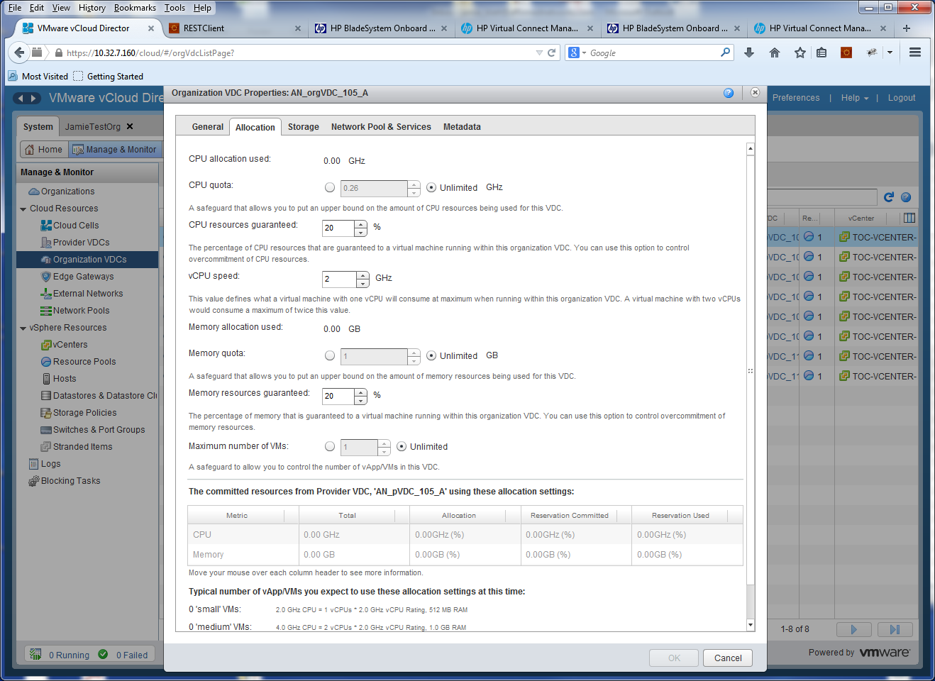

    Thanks for your reply, I tried this on a non vcd setup and the HA failover was clean without any issues. This means something from the VCD side is creating the problem. I checked the VCD config details and the
    resources assigned are unlimited with 20% reservation. Not sure what's from the VCD is creating the problem. Attached is the vcd screen shot
