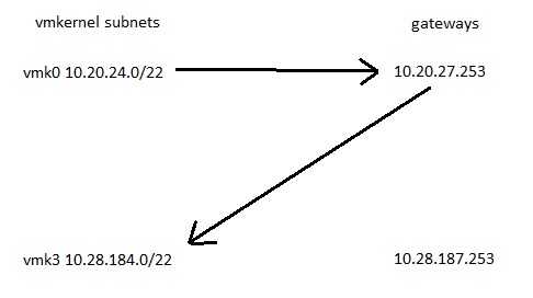

    Thanks for the detailed explanation. Here is the scenario. vmk0 is using 10.20.25.0/22 with default gateway 10.20.27.253 which is the esxi management kernel port group. Assume there is a scsi target at 10.28.184.10 in the 10.28.184.0/22 network with default gateway 10.28.187.253. For software isci I have to create a vmkernel port group. So assume I am creating the vmkernel port group vmk3 with ip address 10.28.184.8, 255.255.252.0 and default gateway 10.20.27.253 (not 10.28.187.253). In this case how will the esxi host reach the scsi server? As per your explanation above esxi looks for the vmkernel port group with ip address in the scsi target network. But my question is vmk3 is configured with irrelevant default gateway. How it can reach the 10.28.184.10 via 10.20.27.253 ? Please help me in understanding this.
    Thanks
    Sai

    Hi Sai,
    That's easy :-)
    vmk3: 10.28.184.8
    iSCSI target: 10.28.184.10
    vmk3 and your iSCSI target IP address are in the same subnet so there's no need for any gateway, default or not, or routing.  IP addresses within the same subnet can talk all day long without leaving the subnet or requiring communication via a gateway.
    Yes, all vmkernel ports assume the default gateway of the management vmkernel port, but vmkernel ports other than management generally don't need to talk outside their own subnet in the first place.
    Here are some examples of use cases for vmkernel ports and how they generally communicate:
    NFS - should be talking only within its own subnet
    iSCSI - should be talking only within its own subnet
    vMotion - should be talking only within its own subnet
    Fault Tolerance - should be talking only within its own subnet
    vSphere Replication - can talk within its own subnet, perhaps a stretched VLAN if across sites, else a static route can be configured
    Did I miss any vmkernel port types?  I think that about sums it up for the most part.
    - Mike
