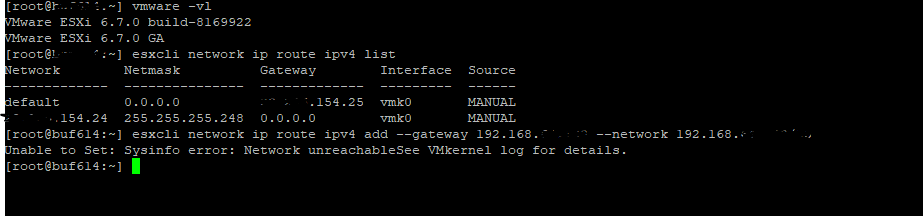

  • 7.  RE: Adding static route for second management interface
    Posted Oct 02, 2019 11:25 PM
  • 8.  RE: Adding static route for second management interface

  • 9.  RE: Adding static route for second management interface
    Posted Oct 12, 2019 07:25 PM
    I tried the old CLI command, I received
    Deleting static route 192.168.0.0/21 from VMkernel
    Error: Unable to find route 192.168.0.0/21 with gateway 192.168.100.1
    I am able to ping from said gateway to the NIC on the esxi server holding an IP within the same subnet as the mentioned gateway NIC.
  • 10.  RE: Adding static route for second management interface
    Posted Oct 12, 2019 11:03 PM
    Please check is there any related route of that subnet?
    esxcli network ip route ipv4 list
  • 11.  RE: Adding static route for second management interface
    Posted Oct 12, 2019 11:07 PM
    There is not, the only two routes shown are from the vmk0 interface which is the default stack interface, which has a default gateway of the public IP and the public IP network with a gateway of 0.0.0.0.
