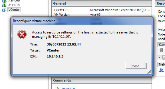

    As a second note to this I have tried doing this (adding the second controller when both powered on and off. Also I have successfully added a ParaVirutal controller to the Vcenter server but when I shut the server down and connect directly to the host to change the primary controller to ParaVirtual I get a access denied message saying this VM is managed by the VCenter IP Address and access denied!! How do you get around that??

    I still have the problem with the VCenter server I was logging into the host locally with its IP address and using the root username and password I thought that should be enough!

    Yeah thinking about it on the training they said add I small VMDK on a different SCSI controller not straight SCSI device, either way sorted now. I just connected directly to the host and removed and re-added to the inventory the VCenter VM but still got the same thing as below..

    Aaaaah, you may have this VM inside a Resource Pool at the vCenter level, and this may be limiting resources. Is this the case? You may have also reservations on the pool... some thing like that.
  • 8.  RE: Adding a ParaVirutal SCSI controller
    Posted May 30, 2013 01:07 PM
    It's in a Failover HA cluster consisting of two servers but that's about it, I have no resource pools setup. I don't think its possible to move it out of the HA cluster is it and even if it was would it solve the problem?
    Thanks
    Duncan
  • 9.  RE: Adding a ParaVirutal SCSI controller
    Posted May 30, 2013 01:09 PM
    Just test one thing: disable the admission control at the HA cluster and then test the VC shutdown and change the settings etc.
  • 10.  RE: Adding a ParaVirutal SCSI controller
    Posted May 30, 2013 01:23 PM
    Dam no joy I'm afraid, silly thing is it will let me add a second scsi controller fine and even change the type when powered on via the VCenter, just not change the type from LSI to paravirtual on the primary controller on the boot partition controller when off via the host
