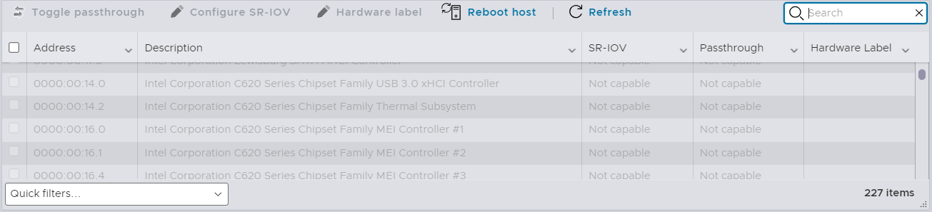

    I want to add a USB device to a virtual machine.
    I plugged the device into the server().
    In the virtual machine settings, when I want to add a device, the USB device menu is grayed out.
    FYI, in Host > Manage > Hardware > PCI Devices, there is a grayed out "C620 Series Chipset Family USB 3.0 xHCI Controller"
    NB:
    -DELL PowerEdge R440
    - vmWare ESXi 8.0.0
    PS : sorry if translation is bad, I'm french
  • 2.  RE: Add an USB device in virtual machine
    Posted Nov 10, 2023 06:45 AM
    Hi,
    at first you need to choose teh host in the vCenter and go to the Configure -> Hardware -> PCI Devices and there set the passthrough device that you will add to the VM. And then you can go to the VM Settings as you described and choose the passthrough device what you will add. So you tell the ESXi to which hardware you will give the direct access from the VM and not over the ESXi drivers.
  • 3.  RE: Add an USB device in virtual machine
    Posted Nov 10, 2023 10:59 AM
    Hi,
    sorry I give you one way but yes some USB devices aren't seen there. Therefor you need to do it other way but now when I looked at the pictures I see that you try to do it directly in ESXi on host. Its needed to do it over vCenter while in ESXi on host isnt the possibility to add in Settings -> ADD New Device -> HOST USB Device which allow you to add the USB Disk attached on the host.
