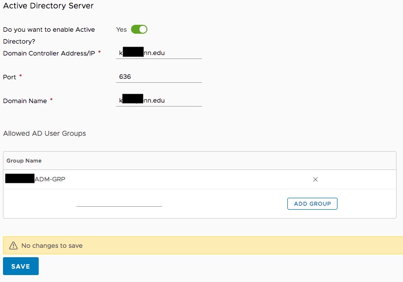

    The AD settings error save happens when i edit the existing information there and click save. It reports that no changes have been made.

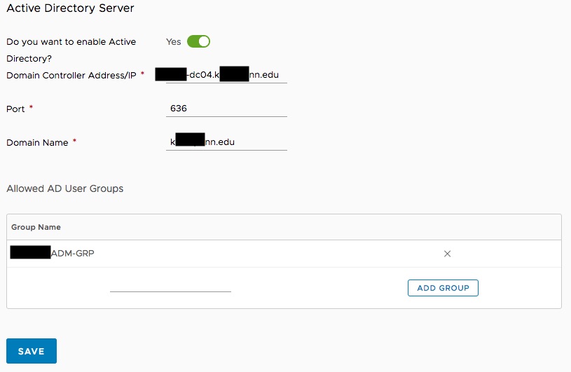

    Original settings:
    I edited the DC information and received the error below:
