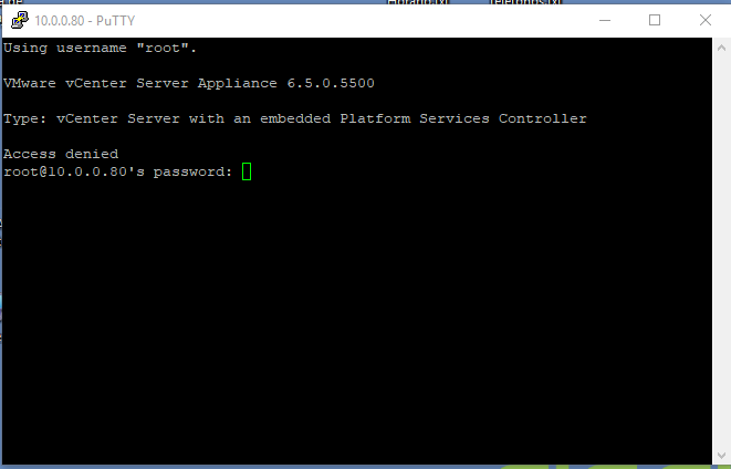

    I was connect by ssh to the server vCenter with the root account, and, today, when i tried to connect to the server vCenter by ssh, i receive this error message:
    But, for example, if i try to connect to the server with the root account on Internet, i can connect without problem:
    What is the problem?

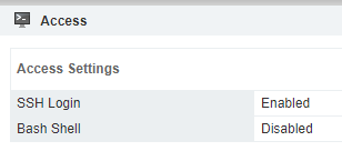

    Is SSH shell enabled along with Bash from the VAMI?

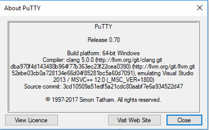

    Could you please tell me your Putty release version so i will test in my Lab for this issue .....

    Hi ranchuab,
    my Putty version is:
    Thanks so much to try help me.

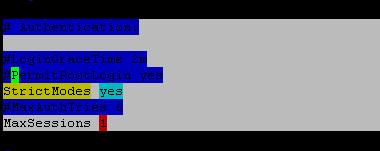

    I suspect problem in /etc/ssh/sshd_config
    Can you check "PermitRootLogin  should be Yes.

    Posted Jan 15, 2018 03:56 PM
    Thanks so much ranchuab
    Your answer solved my issue.
