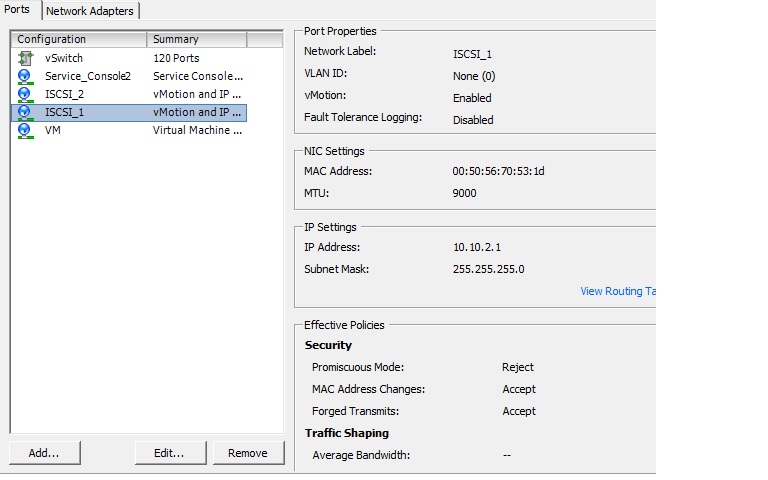

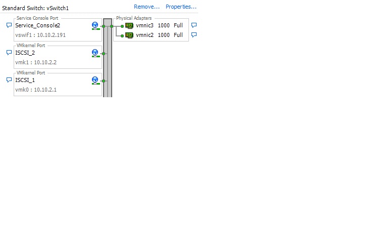

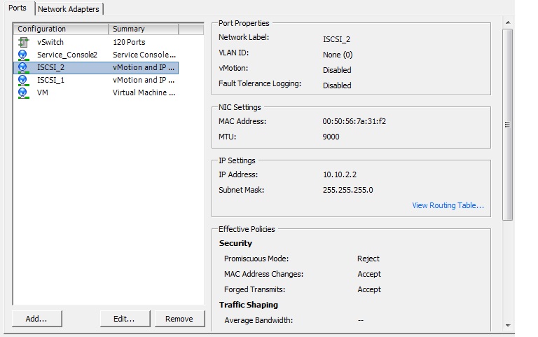

  • 9.  RE: About iscsi share storage connect same target and volume
    Posted Aug 25, 2014 03:24 PM
    Dear André,
    Please see my config. My solution do any step like http://fojta.wordpress.com/2010/04/13/iscsi-and-esxi-multipathing-and-jumbo-frames/
    but i can't enable vmotion on portgroup.
    i mean when i enable vmotion on portgroup 1 as name  'iscsi_1' and try ebable vmotion on portgroup2 name 'iscsi_2'
    when i habe done. it will have one portgroup show enable vmotion. what i wrong ?
    (please see  that picture )
    I think i apply with VMware KB:    Multiple-NIC vMotion in vSphere 5  but not  work How i can do this ?
    Bancha
  • 10.  RE: About iscsi share storage connect same target and volume
    Posted Aug 25, 2014 03:48 PM
    Although it may be possible to run all traffic on only a few port groups with only two shared uplinks, I'd wouldn't recommend it. Firstly you should separate storage traffic from the production LAN, and secondly vMotion can easily saturate an uplink which will most likely cause issues with the other traffic on that uplink.
    Btw. Multi-NIC vMotion has been introduced with vSphere 5. However, according to the screenshots, you are using the classic ESX version which doen't exist in vSphere 5 anymore!? Which version do you use?
    André

  • 12.  RE: About iscsi share storage connect same target and volume
    Posted Aug 25, 2014 04:07 PM
    As mentioned before, Multi-NIC vMotion is not available with ESX/ESXi versions prior to v5. I guest that VMware prevents you from selecting two port groups for vMotion in this case.
    André

  • 14.  RE: About iscsi share storage connect same target and volume
    Best Answer
    Posted Aug 25, 2014 04:34 PM
    Like I said before, vMotion can saturate an uplink, so you will need to keep an eye on this. If you want to run vMotion on the same vSwitch anyway, I'd suggest you create a separate port group with private IP addresses (e.g. 192.168.x.y) for it, and leave both vmnics active for this port group to allow failover in case an uplink fails.
    André
