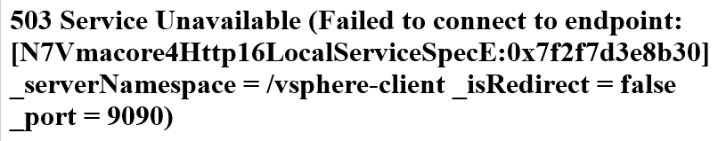

    Error Message:
    503 Service Unavailable (Failed to connect to endpoint: [class Vmacore::Http::LocalServiceSpec:0x000001d47454d440] _serverNamespace = /ui action = Allow _port = 5090)
    Hello guys good evening, I was encountered this error on my host machine when accessing the vcenter server with vSphere Client (HTML5) - partial functionality, any solution or recommendation to solve my current issues on my vCenter Server 6.5 thank you guys and GOD BLESS US ALL...

    If I visit that URL, I get:
    503 Service Unavailable (Failed to connect to endpoint: [N7Vmacore4Http16LocalServiceSpecE:0x00007f98680bcd40] _serverNamespace = /sdk action = Allow _port = 8085)

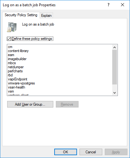

    Posted Dec 08, 2016 11:49 AM
    Our issue has now been resolved and our web client is now fully functional again.
    It appears the following accounts need to be added to "Log on as a Batch job".
    GPO Path: Computer Configuration -> Windows Settings ->Security Settings ->Local Policies -> User Rights Assignment ->Log on as a batch job
    Accounts:
      cm
      content-library
      eam
      imagebuilder
      mbcs
      netdumper
      perfcharts
      rbd
      vapiEndpoint
      vmware-vpostgres
      vsan-health
      vsm
      vsphere-client
      vsphere-ui
    I think the installer is supposed to add the accounts but if this policy is set by a GPO, it is unable to modify it locally.
    I hope this helps some of you.

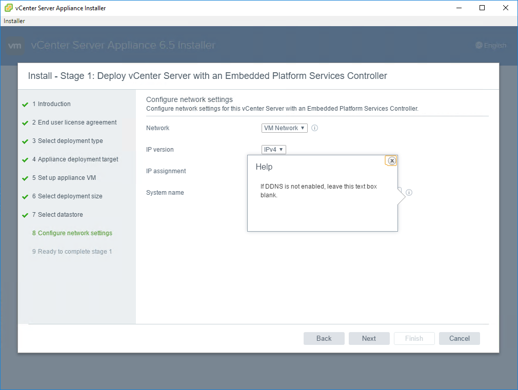

    I seem to have fixed my issue by simply typing in a System name in the dialogue pictured below, instead of leaving it blank, which relied on the DHCP reservation/DNS entry in my router that worked under 6.0U2.
    I've now survived 5 ESXi reboots, using ESXi host reboot, which was set to shut down all VMs gracefully, and to restart VCSA automatically.
    I will continue to test and reboot, but first, a flight to catch, with my server onboard, of course ;-)
    Here's how I was doing 6.0U2 or 6.5 installs, choosing DHCP, and leaving System name blank (but setting up a DHCP reservation for the VM's MAC address, and setting up a DNS name, by suspending the VCSA 6.5 appliance moments after the power up button appears, and grabbing the fresh  VM's MAC, then resuming)
    I don't use DDNS:
    but figured I'd try to put in a System name anyway:
    Five reboots later, I seem to be good, used to fail on first or second reboot/restart of VCSA.

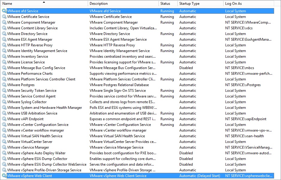

    I had this same issue on a 6.0 u2 windows machine last week after a restart.  If you so choose the installer creates many virtual accounts NT Service\VMware-thingx..etc.  That it uses to log on different services.   On the windows machine I like to use the service-control --start --all command in the \bin of the vcenter folder.  It starts all services or with --stop stops all services in the correct order.  I had mine fail on any vmware service that wasn't using system as checked in services.msc.
    I attempted to use "local service" as I have two vcenters and this was working on anohter, but had the same result.  When I looked at the user rights "logon as a service" no longer had local service in the use rights.  TIP: when you make a GPO to give domain accounts specific user rights, be sure to add the defaults back in.  The gpo does not add the accounts to those user rights it replace whatever values are already there with the ones you set.
    After setting each of those services to the domain account....all is working properly.  Leave the services using SYSTEM account to logon alone.

  • 25.  RE: 503 Service Unavailable (Failed to connect to endpoint:
    Posted Jan 23, 2017 01:53 AM
    LWCSteve, Adding those accounts to my GPO did the trick for me!
    After applying the GPO I restarted the service with service-control --stop vsphere-client then a start - waited a few minutes, killed a chicken as a sacrifice to VMWare and was able to get into the Web Client.
    (I think the sacrifice is optional, not sure if it was needed.)
    Thanks so much!  I've been at this for over a week!
    --Walt

    one thing to check, where is webclient service in Windows based vCenter 6.5.

    As a temporaly solution I delete de profile folders from C:\ProgramData\VMware\vCenterServer\data\vSphere Web Client\SerenityDB\serenity, after delete the profile folders works.
    But I need to fix it definitly because crash frecuently.
    I checked the GPO and not all user are add, and I cound't add it. hi users I couldn't add because doesn´t exist in my server.
      content-library
      perfcharts
      vmware-vpostgres
      vsan-health
    The IPv6 is disabled in my Vcenter Server,
    The DNS is correct in my DC ( register A and PTR)
    The host file it's empty.
    Someone can help me?
    Regards.
    Patricio.

    503 Service Unavailable (Failed to connect to endpoint: [N7Vmacore4Http16LocalServiceSpecE:0x00007fe854035a70] _serverNamespace = /vsphere-client action = Allow _port = 9090)
    http://www.settlersoman.com/wp-content/uploads/2016/07/How-to-change-vCenter-Appliance-VCSA-6.x-IP-Address-7.png
    Hope this helps someone.
