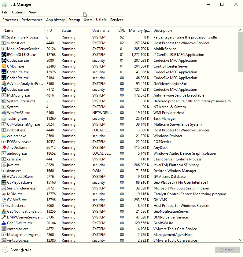

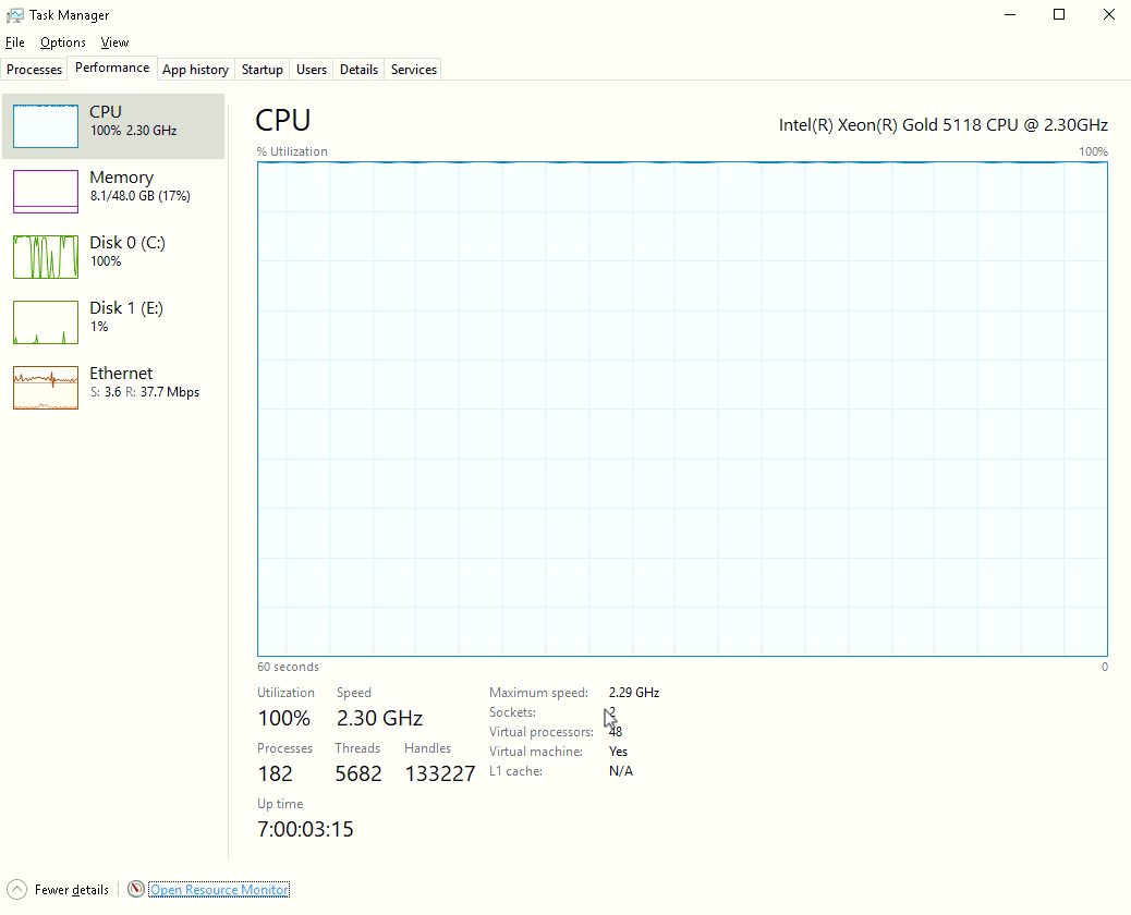

    Okay I am stumped here, after a little while running I have a guest that appears to max out the CPU showing 100% usage however it's not really utilizing 100% because it will show 92% system idle or something like that.
    once the change occurs, rebooting always shows 100 usage
    Win Version is 1703 build 15063.608
    The HOST is showing 100% usage as well

    What is the reason for assigning 24 virtual cores to 2 virtual sockets in the Windows 10 VM? Just because you can does not mean you should.
    Even if a virtual CPU inside in a VM is idle, it still has to execute the HLT instruction for the system idle process and still has to consume CPU cycles. HLT can also cause VMEXIT which in turn also consumes more CPU cycles from the host.
    It is better to assign the vCPU count that the VM can realistically use. If it can only realistically use only 2 vCPU then just assign 2. Assigning 48 means that you can have 46-47 vCPUs which are there doing nothing.

    even with all apps shut down it's showing the 100% usage
    Yet the IDLE process is over 90%
