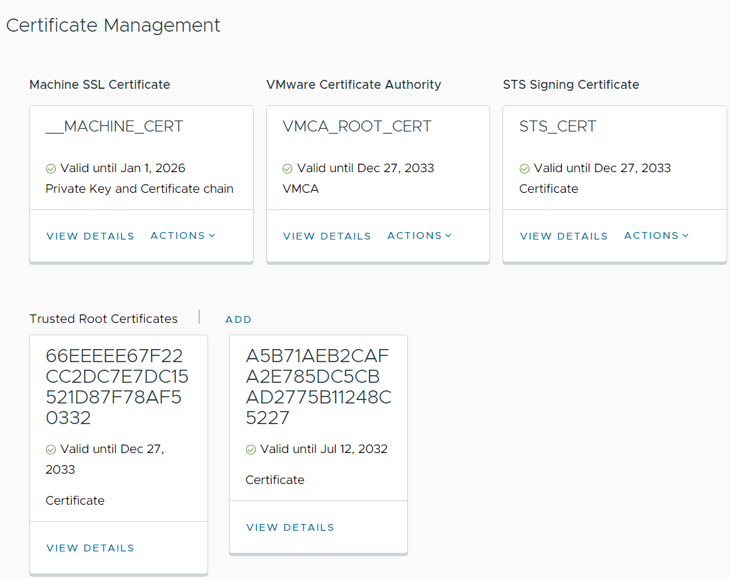

    I have a question from the new year.
    What are the Machine_SSL, STS, and ROOT CA certificates that can see in the vCenter Web UI used for?
    What happens when they expire or are missing?
    I want to make sure I know exactly what these certificates do!

    Trying to make it very simple (even too simple), they essentially serve because within a vSphere infrastructure, communications between/with the various software components that compose it are made secure using "certificates". Keeping it simple, what happens when a certificate expires, i.e. it is no longer valid, communications are rejected and things start to no longer work as they should.
    Machine_SSL - Works on port 443. Then you open the UI of vCenter, it uses the Machine_SSL cert
    STS - Secure Token Service, used to sign the internal tokens for authentication
    Root CA - Certificate Authority, which is the signing cert / root cert
    The services would fail and would not be able to access the server.
