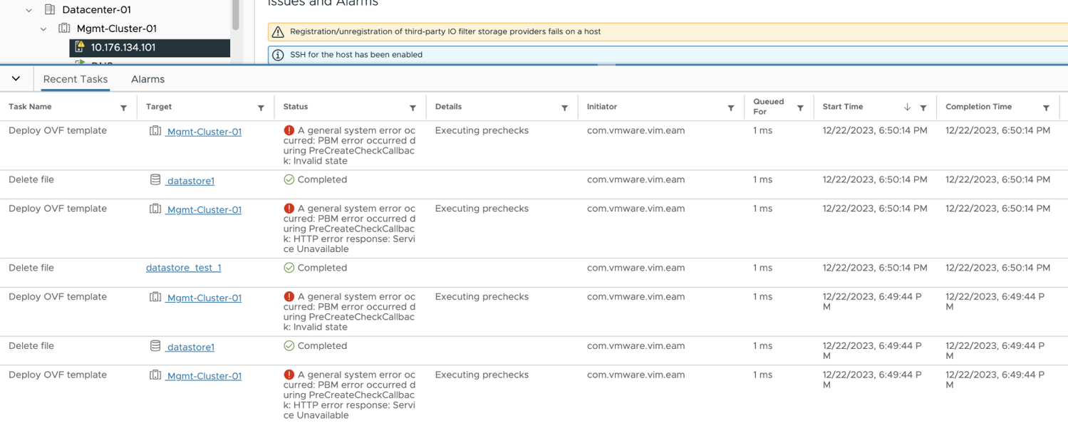

    Hi, recently I have installed the ESXi on the Dell server, and also managed to install the Vcenter on the server. After adding the server host to the Vcenter, for each few second, there are errors reported:
    • In the Recent Tasks tab: Task name: Deploy OVF template; Status: A general system error occurred: PBM error occurred during PreCreateCheckCallback: Invalid state
    • Deploy OVF template; Status: A general system error occurred: PBM error occurred during PreCreateCheckCallback: HTTP error response: service unavailable.
    • There is also a warning showing: Registration/Unregistration of third-party IO filter storage providers fails on a host.
    The DELL server is: PowerEdge R6515 Server
    ESXi version: 8.0U2 custom image (if not using custom image, the 4 hard drives in the server cannot be detected by the ESXi client.)
    Vcenter version: 8.0
    The installation of ESXi and Vcenter is quite smooth without issues, just the errors and warning popped up right after adding the server host to the Vcenter. Also I cannot create VM for the host in the Vcenter, everytime I create VM the operation is failed. I have to create VMs in the ESXi client instead..

    Seems somehow the IO filter storage warining is correlated with the Deploy OVF template errors. After updating the IO Filter Registration on the ESXi Host using the command below, and reboot everything, both the errrors and warning are gone, thank you very much for your time and help!
    /usr/lib/vmware/iofilter/bin/iofvp-ctrl-app -r
