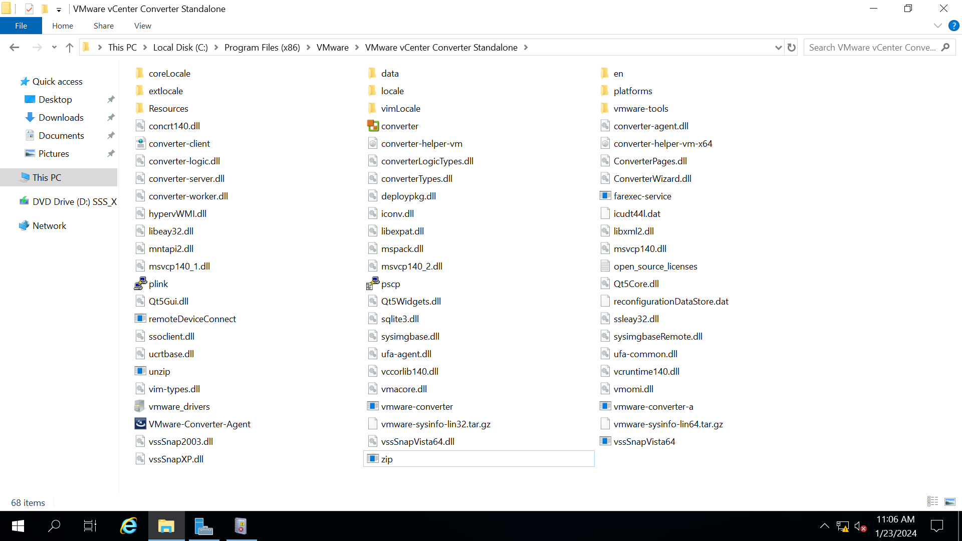

    I have tried installing 6.4 version in new windows 2019. Got the same error:
    Windows Installer installed the product. Product Name: VMware vCenter Converter Standalone. Product Version: 6.4.0.21710069. Product Language: 1033. Manufacturer: VMware, Inc.. Installation success or error status: 1603.

    HI,
    Error 1603 can be caused by several reasons like :
    - Windows Installer is trying to install an application that is already installed.
    - The installation folder of the application is encrypted.
    - There are insufficient permissions to access the location where the software is being installed.
    - Short file name creation is disabled.
    - Conflicts with other software or services that are running on the computer.
    - Conflicts with antivirus or other security software.
    - Corrupted Windows Installer.
    - Corrupted installation package.
    - Unable to access install files in case of a web installer due to network and firewall blocks.
    Please check the machine for above causes, and could you please try this:
    1) Uninstall pre-installed Converter
    2) Clean the installed locations  (C:\ProgramData\VMware\VMware vCenter Converter Standalone and C:\ProgramData\VMware\VMware vCenter Converter Standalone Client)
    3) Reboot the machine
    4) Install converter again
