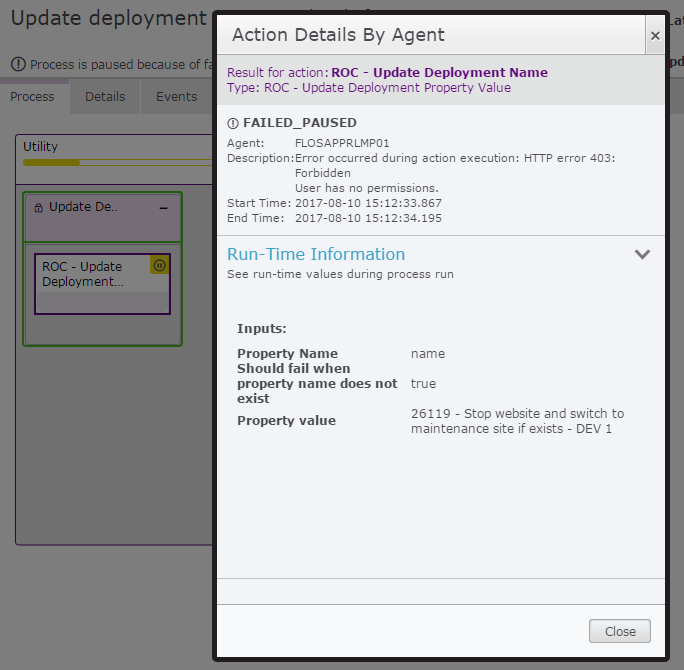

    In a pre-deployment step I use this action to automatically rename the deployment being created and it usually works well.
    But now I am in the case where the deployment is created by a user with low permissions in RA:
    and then he gets the following error :
    I am surprised about this behavior, what are the minimum permissions required to be able to run a deployment plan embeding this action ?

    Thanks for your answer, but I don't create a deployment plan.
    The error is occuring in the Pre-deployment step which is executed when the release (deployment) is created.
    My user is Release Designer, so I thought he would be able to update the name of the release he is creating.

    Hi Stephane,
    I ran a quick test and Release Designer was sufficient to run the action "ROC - Update deployment property value" in a predeployment step.
    • What release/build are you running? (I tested it in 6.3 b9840).
    • Is it the first action in the predeployment step? If this one fails, I would expect every action within predeployment to fail with the same error?
    • Was the deployment plan created from the Tools template?
    regards,
    Leo

    • I am running 5.5.2.511
    • It was the only action in the process, but I made another test by adding a "delay" action or "compare" before the property update action, and the action does'nt fail, only the property update action fails.
    • Yes the deployment plan have been created from the Tools Template, otherwise I can't deploy it on the target environment.
    Regards,
    Stéphane.

    Posted Aug 23, 2017 05:17 AM
    Found it !
    I was using a user who was at the same time declared as a standalone user and member of a group. I was setting the permissions on the group but it was the standalone user that was used.
    Removing the standalone user solved the issue.
