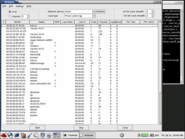

Once those commands have completed, AirSnort is installed on your machine. Run AirSnort within your favorite GUI environment on Linux, and then you'll see the figure presented in Figure 1.
Figure 1: Sniffing packets with AirSnort
Once you have your wireless card active, press Start and begin collecting packets. The most common question now is, how long should you wait Here's how AirSnort cracks a WEP key. A weak IV, as discussed in Part I of this article, can assist in exposing only one key byte. AirSnort collects these weak IVs and sorts them according to which key byte each assists in exposing. When a sufficient number of weak IVs have been gathered for a particular key byte, AirSnort computes the probable value for that key byte using some advanced statistical methods. Once these probable values have been generated, AirSnort makes a guess at the key based on the highest ranking values found in the statistical analysis. Typically, there is approximately a 95% chance that a weak IV will reveal nothing at all about a key byte. It may require only a few packets before a key byte is revealed, or it may require many times more. Thus, some keys will be generated and tried fairly quickly, whereas others will crack much more slowly. Regardless, after a while, AirSnort will calculate the key and present it to you. At that point, associate with the wireless network, and you're now effectively connected to that LAN as if you were plugged in via a standard wire port.
