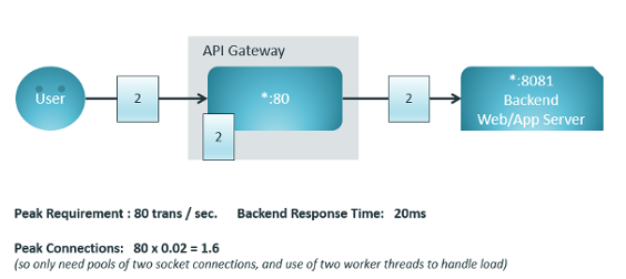

2. Running under Optimal conditions
Our basic system is where API Gateway is being used as a basic proxy.  Our target load will be 80 TPS, and under working conditions will have less than 20ms response time :
Our peak requirements for concurrent transactions (ie number of sockets we will need open, and number of active worker threads) will be less than 2.  Two threads are enough to handle all the traffic at 80 trans/sec & 20ms response time.

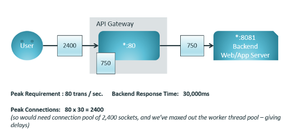

The most common cause of failure in production is when a back-end server starts to respond slower than expected.  For example if the backend server goes from a 20ms response time to a 30sec response time - then we need the following :
The max-capacity is = num-parallel  * transaction-time.    When we had 20ms transaction time, we did not need to keep many transactions running in parallel (2 was enough).  Now we have trans time of 30sec, we need to run 2,400 open requests.  To maintain the same throughput/capacity as the transaction-time increases, we need to increase the width of how many transactions we can run at the same time.
However, we have a "bottleneck" with the default io.httpMaxConcurrency=750, then the API Gateway will only process the first 750 requests, those will be send onto the backed, where they will take 30sec, and only as requests finish will new requests be processed.   A new request arriving at the gateway will wait [(2,400 / 750 ) * 30sec = 96sec] and then take 30sec to process.
The max-capacity if API Gateway with a MaxConcurrency=750 and with (degraded) performance of 30sec response time, is : (750 / 30) = 25 requests / sec, 25 TPS.
Since in PROD environment (or with proper load test) the requests will still keep arriving at the API Gateway at rate of 80 TPS, the API Gateway will start refusing to take new requests, and delays even longer than 30sec will be felt for those transactions that are processed.

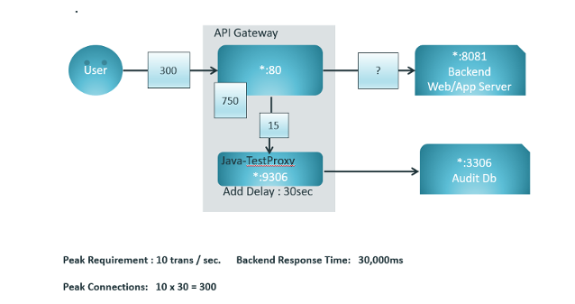

8. Example 4- Adding delay to Audit DB connection
Here we test conditions where a remote "Audit" database is responding badly.  We have setup a remote audit database, and then access to the jdbc is via our java-TestProxy so we can add delays on any audit records that are written to the database.  Here is out test setup :
And here is the video of running that test-case :
Note: In this setup, we are running the java-TestProxy on the API Gateway itself, whereas in the other examples we were running the proxy on the backend server.
