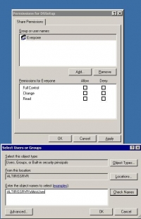

Share the DSSetup folder on the server
On the server, go to C:\ in my computer. Right-click on the DSSetup folder and select “Sharing and Security.”
Select “Share this folder” and click on the “Permissions” button.
Unselect “Read – Allow” for Everyone.
Click “Add”
Type in your altiris user name ( ex: “AltirisUser”) and click “Check Names”
Click “OK”
Click “OK” Click “OK”
