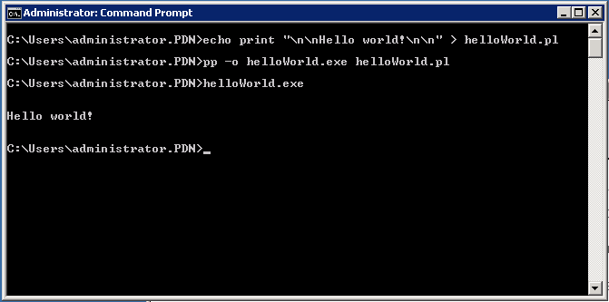

You can test PAR::Packer like this: -
echo print "\n\nHello world!\n\n" > helloWorld.pl
pp -o helloWorld.exe helloWorld.pl
helloWorld.exe

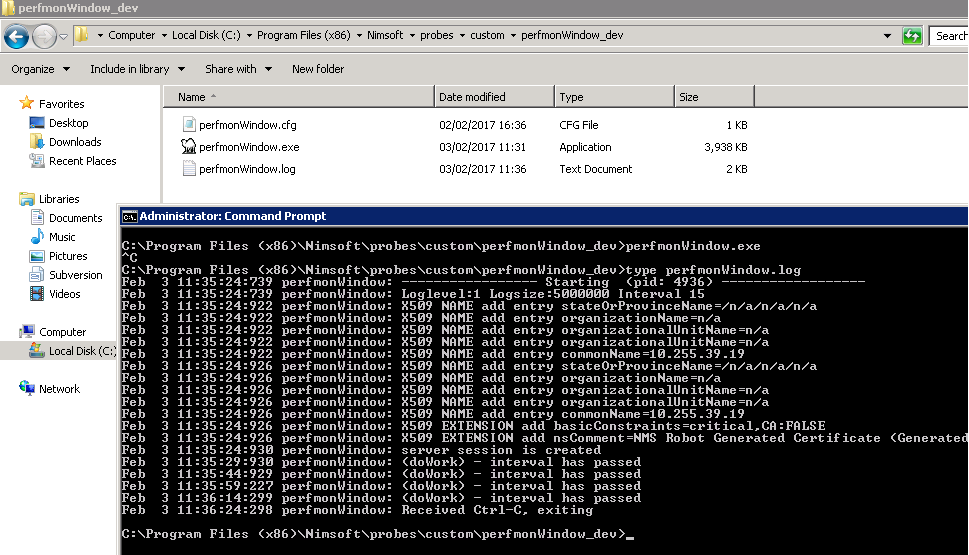

Then run the executable, wait for a couple of minutes and hit Ctrl-C. Then look at the log file and hopefully you should have something like this: -
Congratulations if you have got this far. You can move on to the next part.

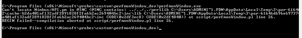

If you see any errors when running the probe, check that you have the SDK_Perl package installed and you are working with the directory structure as seen above. If the system cannot find or reference the API libraries, the probe will not run. You must make sure they are installed, and your use statement at the top of code points to the perllib directory.
