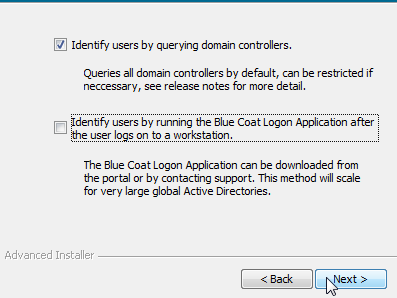

    While installing Auth Connector, we have two options, the first option indicates that it is going to query all domain controllers. In our case Auth managed to syncronized users from both domains. But it won't recognize user credentials who is coming from XYZ.local. We have not tested the ACLogon option (the second).

    We Install Auth Connector on the one of the Root Domain Member Server i.e. mydomain.com, VERY IMP - The Service Account Crendentials should have the ability to Read the Whole Domain Tree both Root and Parent Domains, While Installing Auth Connector Check Mark - Identify users by querying domain controllers
    Force a SYNC with AD on WSS and check if you see all the Users from all the Domain. This should get things working
    In one of the customer deployment I had faced an Issue where the Root Domain takes alot of time quering the Parent Domains resulting in Unauthenticated users. The Only option here was to Install ACLogon.exe on all the End User Systems
