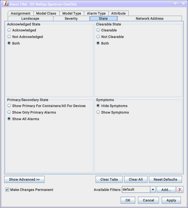

Silvio Okamoto's profile image
Broadcom Employee Silvio Okamoto
You could have set to Hide Symptoms alarms in Alarm Filter.
https://techdocs.broadcom.com/us/en/ca-enterprise-software/it-operations-management/spectrum/24-3/managing-client-applications/using-oneclick/monitoring-your-network-with-oneclick/manage-alarms.html
Thanks,
Silvio
