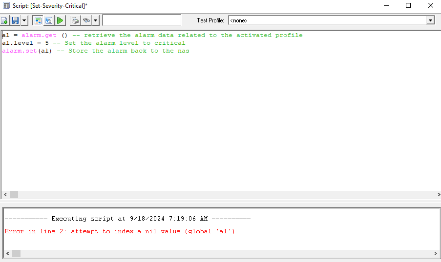

Mike Bowling's profile image
Mike Bowling
Is there something I need to modify?
Garin Walsh's profile image
Garin Walsh
alarm.get () in an AO profile returns the alarm data that invoked/matched the profile. When run within the IDE, there's no invoking AO profile and so no alarm. That is why it returns nil.
If you have the nimid of an existing alarm, you can supply that value as a string argument to the function for testing.
When I am testing I will use something like
al = alarm.get ()
if ( al == nil ) then
   al = alarm.get ("AB1234567890")
end
But for prod usage, you don;t want that because it's possible for an alarm to disappear between when the AO is invoked and when you go to use it.
