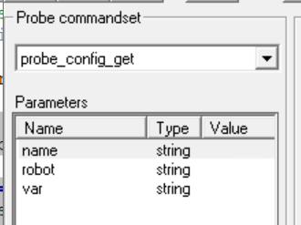

And third, your call to get the probe config isn't right (unless it's doing more that I have tried in the past) - It will need these specified:
where name is the probe name (sql_response in your case), robot can be left blank, and var, if specified, needs to be the path and key name of an item in the cfg file. The password in the sql_response cfg file is going to be /connections/NAMEOFCONNECTION/password.
If you leave var blank, you will get a PDS containing a table of the entire config file.
