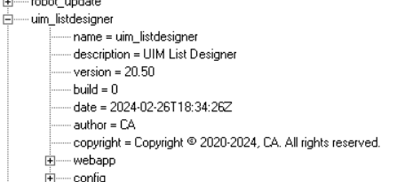

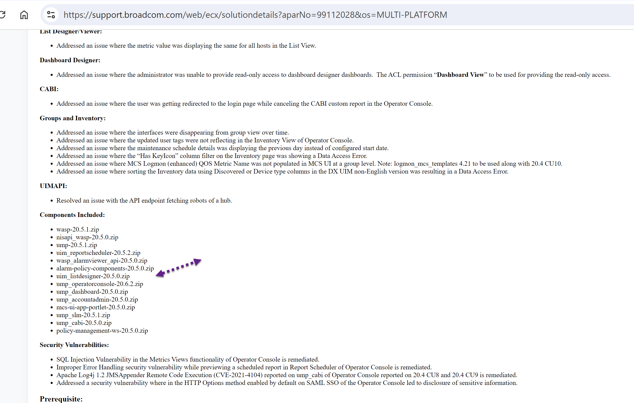

Please confirm if the listdesigner webapp is correctly updated i.e uim_listdesigner - webapp:20.50 as that the version in 20.4 CU10
https://support.broadcom.com/web/ecx/solutiondetails?aparNo=99112028&os=MULTI-PLATFORM
I dont  see log4j-1.2.17.jar in my test env in 20.4 CU10 in the listdesigner webapp

Yes it is actual:

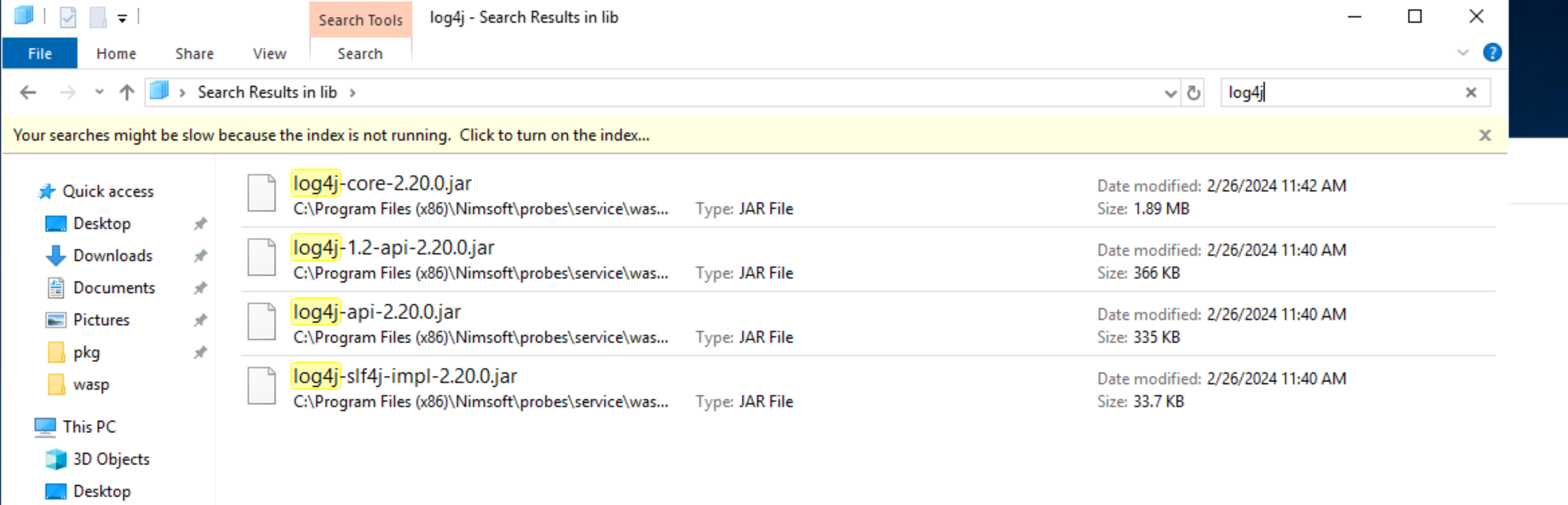

I can aknowledge, that a redeploy made it, now the log4j 1.2.17jar is gone.
Interessting...shouldnt this be happened by the Update-Process, however, my security-folks is satisfied now :-)
