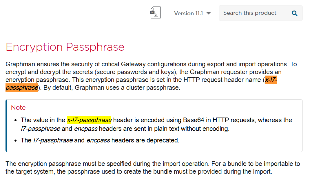

I tried with your secret entity and understood that your passphrase is not actually test, but base64-decode version of it. You might have misinterpreted the x-l7-passphrase header. Let me summarize it here:
x-l7-passphrase: it is a HTTP request header for carrying the base64 encoded version of your custom passphrase for encoding/decoding the secrets to/from the bundle.
com.l7tech.bootstrap.graphmanBundles.passphrase: it is a java system property for carrying the plain text version of your custom passphrase for decoding the secrets from the bootstrapped bundles.

thank you Gurram for the explanation.

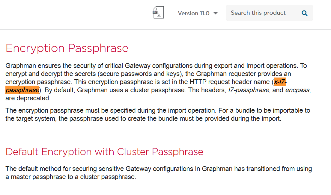

I can see it's new in 11.1 version.
the base64 encoding of the header is not specified in the 11.0
11.1 add this comment.
