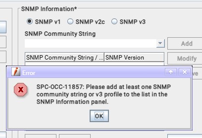

You must supply at least one snmp community string in your discovery configuration. If not, you get the following error when trying to run it.

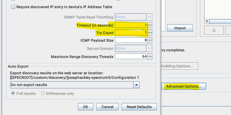

What you can do is click the Advanced Options button and set the Timeout (In seconds) and Try Count parameters to 1.
