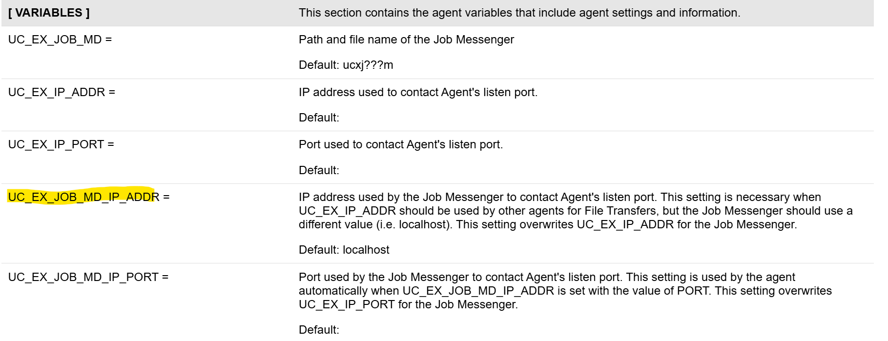

It seems that the name of the variable in the ini file you use to set the address of the job messenger is not correct. You can find the right name in the screenshot from the documentation below.
Hope this helps,
Oana
