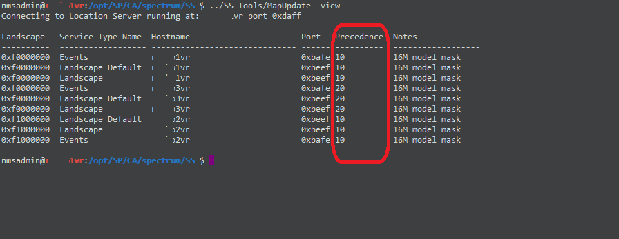

Catalin Farcasanu's profile image
Catalin Farcasanu
The  MapUpdate utility provides this information.

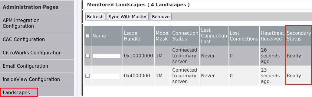

Raj.A's profile image
Raj.A
You can check the secondary status through OneClick web UI.
Administration --> Landscapes.
Regards,
Raj
MARUBUN SUPPORT's profile image
MARUBUN SUPPORT
If the status is "Ready", does that mean the secondary server is ready to be switched over?

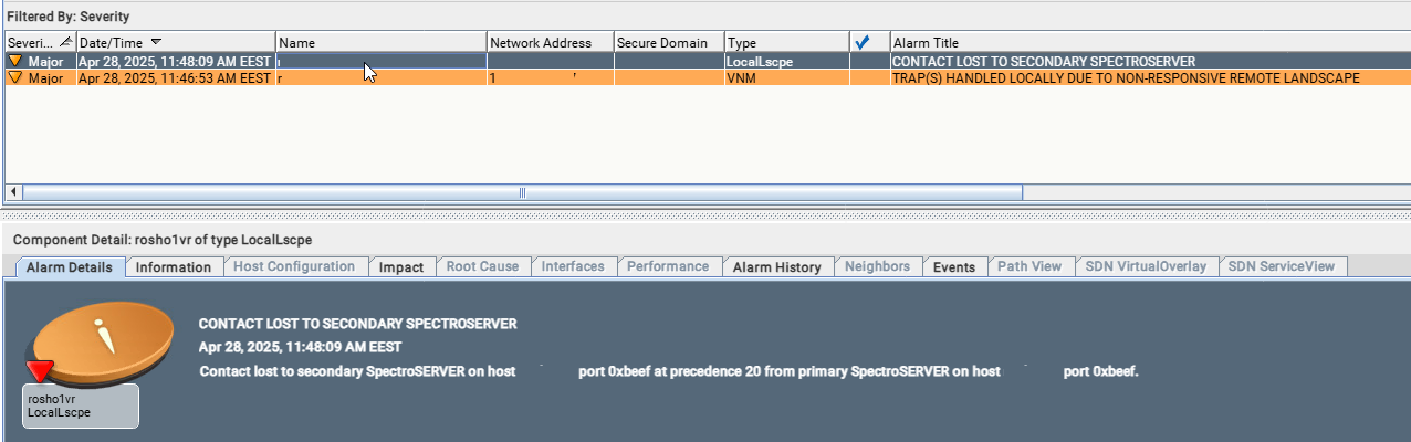

Catalin Farcasanu
I think it's obvious that the condition you want to check first, is the existence/non-existence of the "CONTACT LOST TO SECONDARY SPECTROSERVER" alarm in OC. You can have an email sent, whenever the alarm occurs. This what the system checks for itself.
A running process does not necessarily mean that the process is doing what is supposed to be doing.
The SS process is called SpectroSERVER/SpectroSERVER.exe. Process Daemon is responsible for keeping up running all Spectrum required processes. These are described in the documentation and also in the 200 Administration course that is available.
