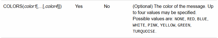

I see through opslog you can access/filter on message color -
Curious if anyone has found a way to capture all red messages via opsmvs message rules- (based on the fact it is red)
Went through the tech docs and did not find anything related but thought someone smarter than me might have figured this out!

Not sure what you are looking for, but you can make an OPS/REXX to work with the OPSLOG function which can filter by color.
Or else make a generic message rule which would be like )MSG * and check on MSG.COLOR variable.

The OPSCOLOR function can be used to process the MSG.COLOR variable. For example, the message color can be found and also changed.
IF OPSCOLOR(MSG.COLOR) = 'NONE' then
   MSG.COLOR = OPSCOLOR('TURQ')
Since one can change the message color by just setting the MSG.COLOR, the color of the message does not mean the same as the descriptor code (msg.desc) for certain applications.
Please also check out the ‘Note’ part of our Techdoc about MSG.COLOR:
