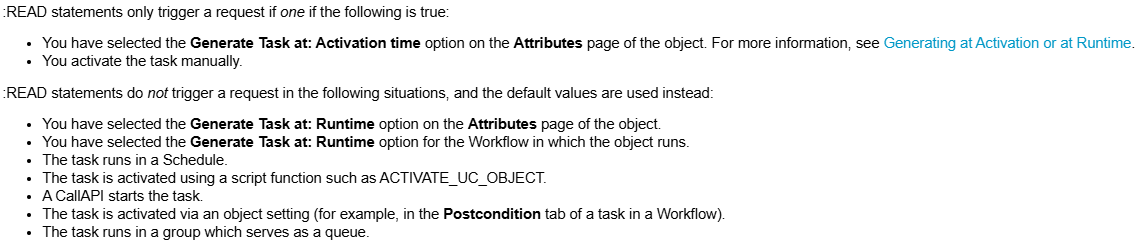

Maybe there is an issue with the read buffer?
:READ function have some limitations
You could try &$ACTIVATOR_RUNID# instead of &UC_CAUSE_NR#
