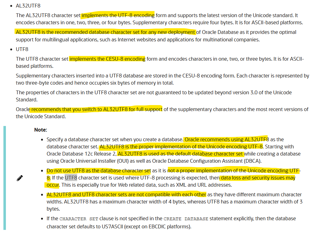

note that the DB-Load and migration tool check if the character set is exactly AL32UTF8 (there are other UTF-8 character sets available in Oracle DB, but this exact one must be used, otherwise the installation does not proceed).
As recommended by Oracle, "AL32UTF8 is the proper implementation of the Unicode encoding UTF-8." and "AL32UTF8 is used as the default database character set".
https://docs.oracle.com/en/database/oracle/oracle-database/19/nlspg/supporting-multilingual-databases-with-unicode.html
