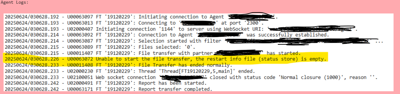

Agent Logs:
Could you please someone help on this matter.

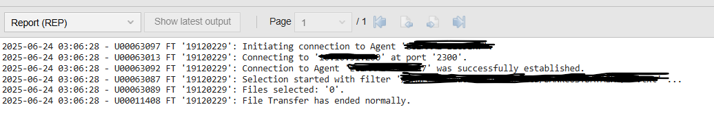

Thanks for your response please find below new transfer log (when the job actually ran)
Problem is that same job is working on V21 agent but not on V24 agent:
Job Log:
Agent log:

I'm confused now...  Are these new screenshots from your v21 agent or your v24 agent?
It is saying 'Files selected: '0''....are there actually files in that location?
