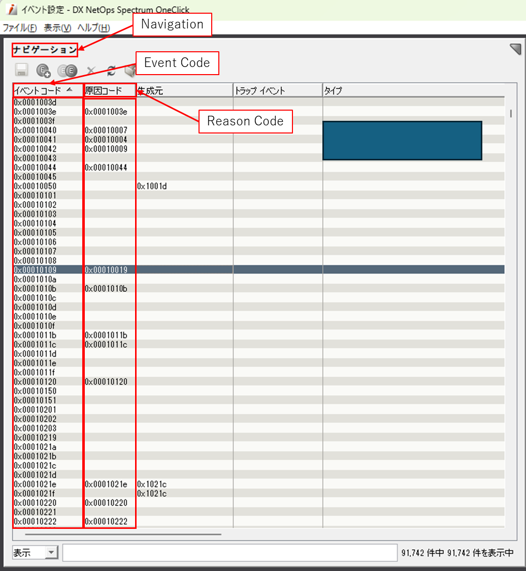

As shown in the Screen Shot below, there are "Event Code" and "Cause Code" items in the "Navigation" window.
Could you please tell me the meaning of the "Cause Code" displayed here?

You should read this. Better off, read the entire chapter "Event Configuration". It describes how events and alarms are configured in the system. CsPCauses codes are related to files for each alarm that is created.
Joern (DB Systel)'s profile image
Joern (DB Systel)
The short answer is: "Event Code" is the "Type/Code" of the Event - "Cause Code" is the "Type/Code" for the Alarm. The long answer is in the documentation as Catalin said.

I'm sorry for asking such a basic question, but I would be very grateful if you could point me to a manual or document that contains a list of "Type/Code" of the Event and "Type/Code" for the Alarm that include the Reason Code in the screenshot I have attached to this question.

There is no direct document that lists all the event/cause codes as it is a huge list. To view the configured and available event/cause code, you can use Event Configuration Editor or Respective Event Configuration files under $SPECROOT/SS/CsVendor/ folder or under $SPECROOT/custom/Events/ for any customized events.
Similarly, You can find probable cause files under $SPECROOT/SG-Support/CsPCause/ or $SPECROOT/custom/Events/CsPCause/ folders.
Please refer the below KB article.
https://knowledge.broadcom.com/external/article/15453/how-to-get-all-the-events-by-severity-in.html
